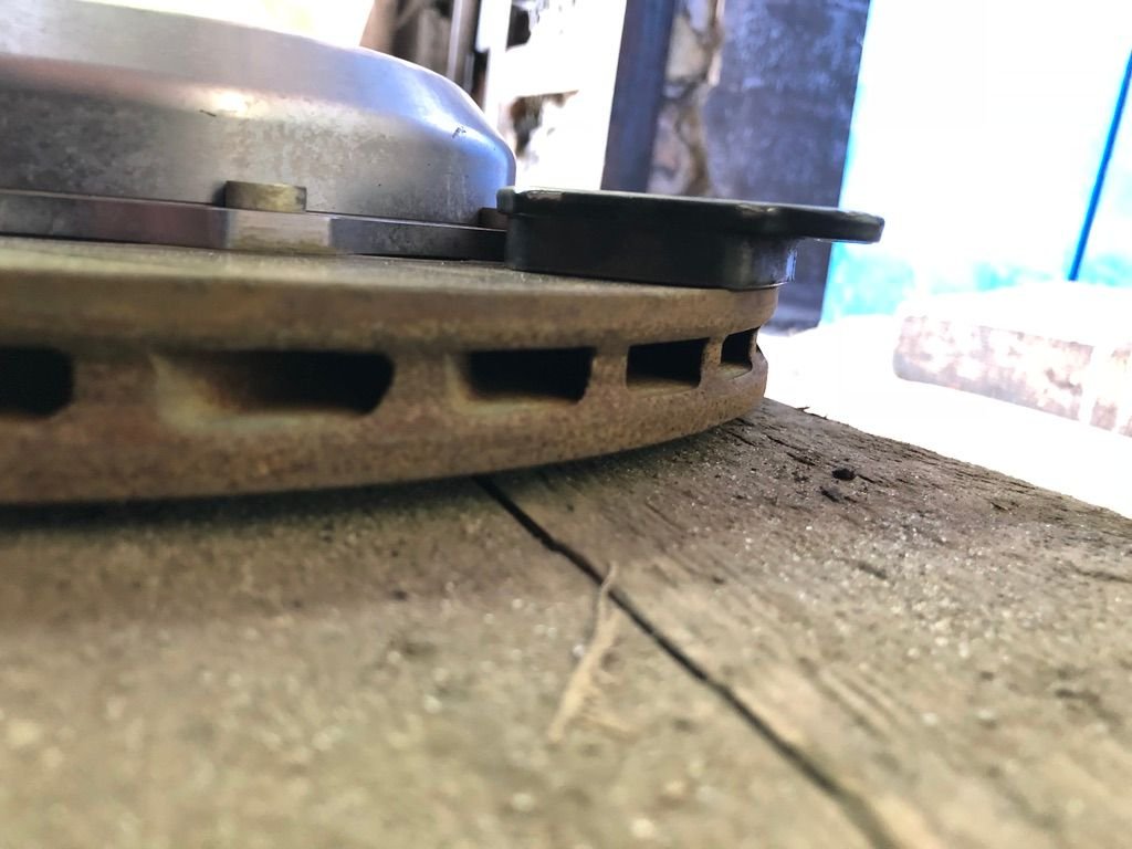

OK, I've made some pictures today.
So this is pad on the disc. There's no clearance on the "bolt" side but lots of pad goes "offsite". It shouldn't work like that
OK, this is actual disc. Text is correct.

...and this is how it looks from top view.

Definitely odd. Maybe contact Girodisc and see what they have to say.

OK, so I'm an idiot... Guys, when you buy used stuff make sure you really understand what to do
In a nutshell: what i see is NORMAL. Rear brake pads has to be trimmed with Girodisc 2 pcs rotors.
Here's what Girodisc guys replied:
Anton,
Hello and thank you for getting in touch, our rotors do require the pad backing plate to be machined or ground down to match the arc of the pad material so that it clears our rotor hat and hardware. We include a disclaimer/template with these rotors explaining what needs to be done, I have also attached it to this email in case you missed it in the rotor box. This is necessary because we can’t physically make the hat any smaller due to the size of the parking brake, we need a certain amount of space there for our hardware arrangement.
All of the pads that we sell, our Magic, S/S and the ST43 from Raybestos, all come machined from us so they are plug and play. Ferodo also has a shape that does not need to be modified.
Let me know if you have any other questions, thanks!
