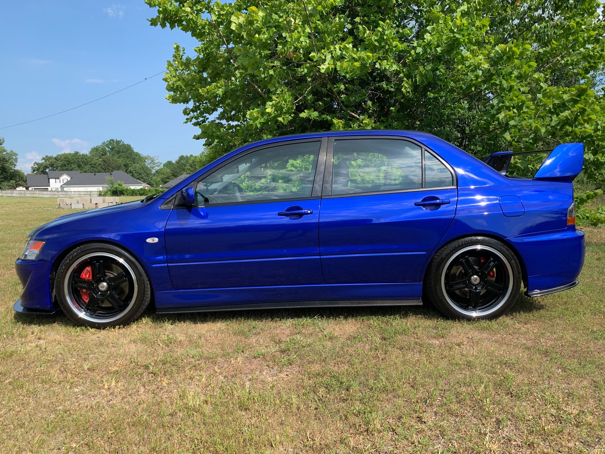

I am running stock suspension on my 05 Evo8 and the rears have been squeaking real bad in the cold for a few years now. I had been trying to apply lubricant to the shafts but no luck. I suspect it is time that I look at replacing them. I don't know much about suspension other than some basic reading so I am hoping some input would help me make an informed decision.
Goal:
1. I don't want to loose any performance/grip based on OEM.
2. Street car so I don't want to make the ride more rough.
3. I wouldn't mind the option to lower the ride height a little bit but I'm not sure how much I would be comfortable with. Do they make adjustable ride height options so I can play with what I like? I have 245/40/R18 which raised the overall height of my car a little.
4. Budget is under $3k but don't have a desire to unnecessarily spend the budget.
Thanks for any feedback you are willing to offer.
