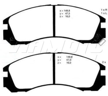

So, I have a -97 Lancer Evo IV. Quite stock, stock brakes. I’m looking to change the front brake pads. I live in Sweden so the local places to get parts (fast) are a little limited. I’ve found some OEM brake pads but if i inspect my current ones, they don’t look alike. So basically my question is, if they’ll fit? I have limited time and space so I would rather not remove everything just to check, if I don’t have to.
These are the ones I’m looking to buy.

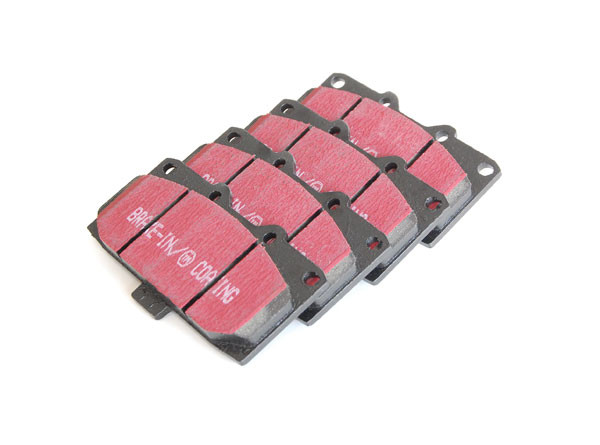

although, the ones that are on, from what you can see without removing the wheel and brake caliper seem ro look like this;
i’ve never done a brake job on these, that’s why I’m asking since there seem to be so many different looking brake pads.

I can't see the images, but you'll need any brake pads that are an equivalent of Mitsubishi MR389549. I see lots of options in Europe on SpareTo, etc.

the first pic shows the pads have guide pins(and hole for the spring) on the top. does you caliper have those? those look similar to mazda brakes
The 2nd pic looks like basic brakes pads for single piston calipers
