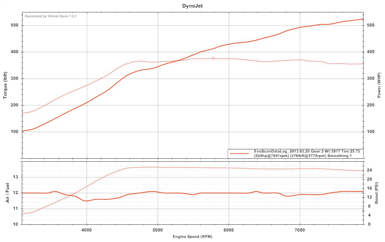

2013 Gsr EF4 500+whp

VD calibrated to Local Dynos (Dynapack and Mustojet) (FYI)

Very nice! Mod list? 91oct?

MAP Fully Ported/Thermal Coated EF4 Turbo
> GSC S2 Camshafts
> GSC Beehive Springs and Titanium Retainers
> Grimspeed 3-Port
> APR Headstuds
> Bardabe Performance UICP
> Bardabe Performance 3.0" Intake w/ Velocity Stack
> ETS 4" FMIC
> ETS LICP
> ETS Version 2 o2 Dump
> Tomei Straight Titanium Test Pipe
> Tomei Titanium Catback
> ID2000 Injectors
And a kick *** tune by ME!

post on smooth 6 and with temp correction,
This is not a valid VD graph.

Jon you're making me want to upgrade and it hasn't even been a year with your tune. This graph looks pretty legit here, smoothing it to 6 would only make a smooth graph even sweeter.
question: What fuel pump ? Did he use a pressure regulator ?
LOL, please continue to tell Jon how to use VD, its amusing...

david, without temp and baro correction is not a properly correct vd. not?
its SAE 1.0 here every day dude.....
