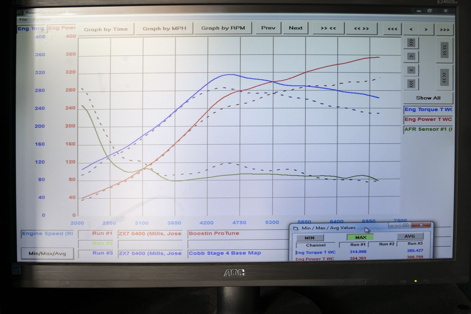

Up to this point I'd been running the Cobb OTS Stage 4 MAP via AP3 with the load tables and MAF scaling adjusted for the AEM piping. The car was running very well with great drivability and was a huge improvement over stock, though it did seem a little rich. While I don't daily the car, I do drive it whenever it's nice and it spends 99% of it's time on the street (1 or 2 road courses a year). Maximum reliability and drivability were my chief concerns.
Having heard such good things about the work Devin and his team do, it was time to see how well the car was really doing and if there were some additional gains to be realized. My knock sum was never over 1.0 and the wideband seemed like it always stayed in a safe range. Max boost was around 27, though more often than not it was around 26 according to my gauge recall and the AP3.
So first off, all the great things I'd heard about Boostin Performance were absolutely true. The whole team there is incredibly professional, super polite and genuinely cares about their customers and their cars. I immediately felt at home with these guys; it's a very "family" environment. The shop is spotless and you can see how much pride they take in the work that they do. If you're anywhere near Chicago, I can't recommend them enough. These guys truly give a s#$%.
If you read this far, I highly recommend checking out the video to see the whole thing. Otherwise, there's spoilers below.
The TL;DR is stock a Evo X GSR makes around 200whp on their dyno. We made (drumroll) 354whp at 27 PSI on 93 octane. A 77% increase over stock on a totally safe, streetable tune made me super happy. It was a nice pickup over the OTS map as well. Here's a screencap of the final difference between the OTS and where we finished up:

fp oil line feed was upgraded cause?
and is it mustang dyno?
Oil feed line came with the kit; from what I understand the stock line doesn’t support enough oil pressure for the upgraded turbo, or something to that effect. The 4B11 puts the oil feed in a different spot than the 4g’s did.
And yeah, Mustang dyno. Stock cars do 200-220 with the way theirs is calibrated (they have Mustang do all the calibrations). It’s a bit of a pessimistic dyno =)
