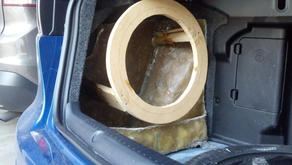

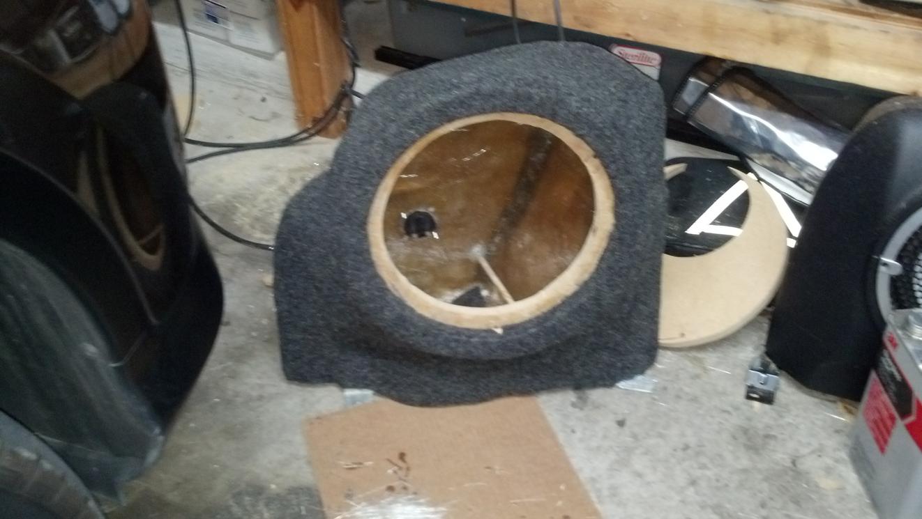

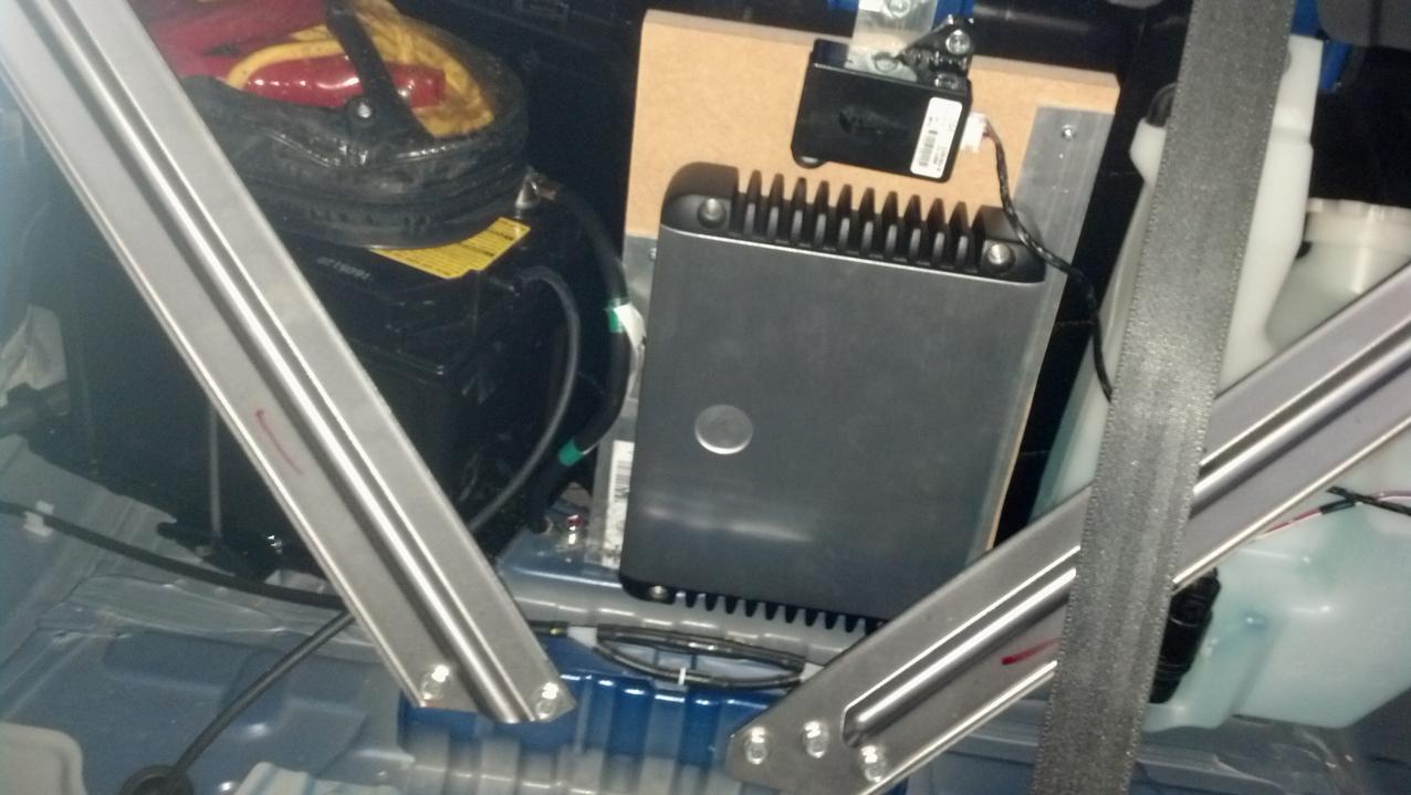

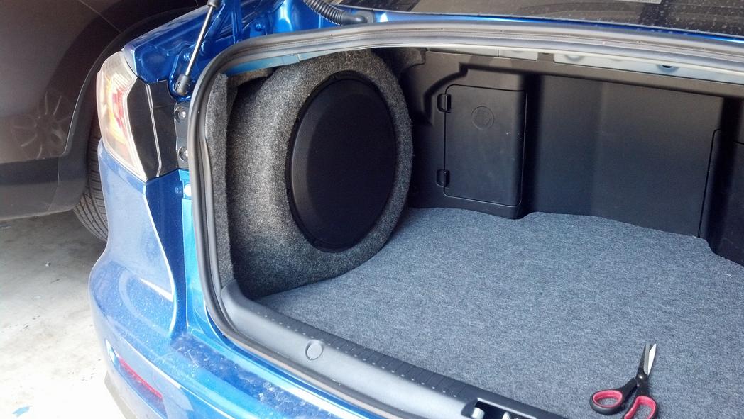

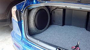

I'm so glad to be rid of the MMCS. Here's an abreviated list of what I've done:
Kenwood DNN990 head unit.
Mito-02 harness adapter
iDatalink Maestro SW (retains steering wheel button functionality with aftermaket radios - works great)
Focal speakers in front and rear.
Custom MDF ring adapters for mounting made of 1/2" MDF and 3/4" MDF screwed and glued together. See the japanase Alpine speaker adapters for an idea on how to build.
14 ga speaker wire run to all doors and sub.
6 channel Stinger RCA cable

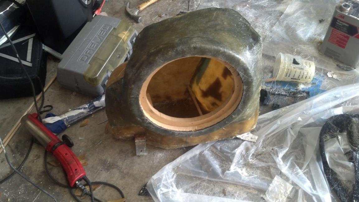

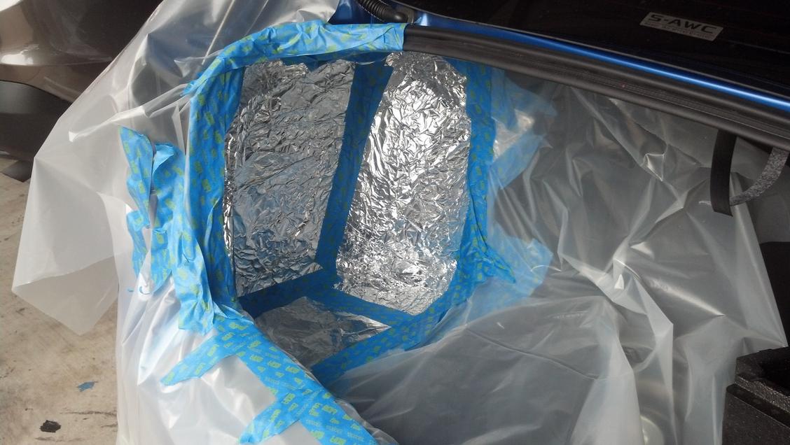

JLAudio HD900 amp mounted in trunk. 4ga wire run from battery to amp.
Custom sub box with 12" JL sub.
American International Mitk894
It sounds 100 times better and the stereo actually functions now.
Attached Thumbnails Replaced the entire MMCS system-img_20130427_175937_432.jpg   Replaced the entire MMCS system-img_20130520_194258_097.jpg   Replaced the entire MMCS system-img_20130526_114350_808.jpg   Replaced the entire MMCS system-img_20130607_204006_869.jpg   Replaced the entire MMCS system-img_20130608_132725_706.jpg

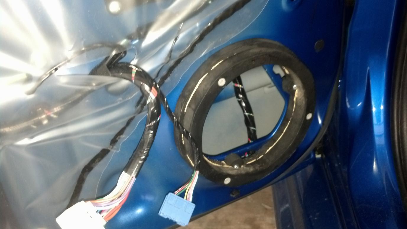

Best part of this build is I didn't have to mess with ripping the factory stuff apart. I can easily swap it back to stock with minimal effort.
I saw people epoxying tweeters in their door panels. That's just dumb. I made a simple bracket that'll allow me to remove them if necessary.
