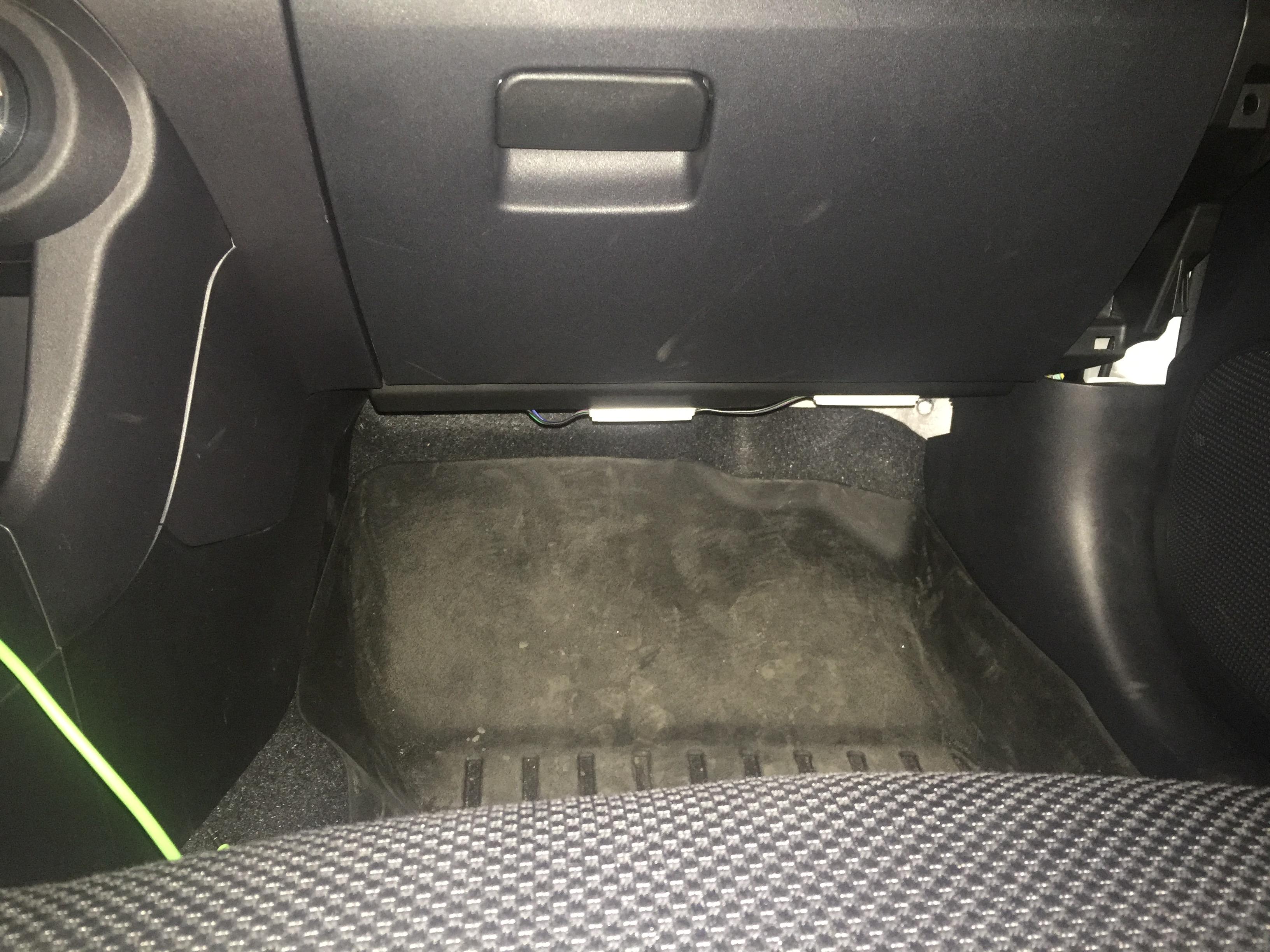

Hey guys, figured I'd post some info on how I added some footwell lighting to my Evo X. Here's a quick video of the finished thing:
I am alternating between 3 brightness levels and my "rave" mode with the button on the left of the cluster of 3:

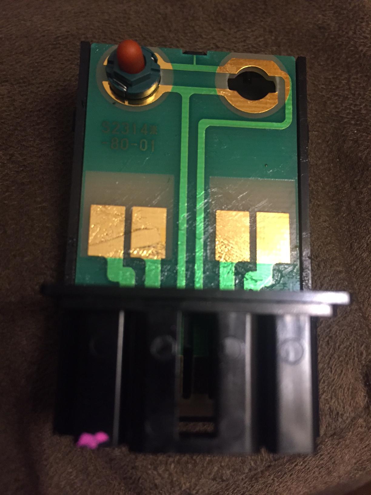

I wanted to keep it as clean and OEM looking as possible. So I replaced one of the blanks on the center console. I bought an AWC switch on eBay for $15. I did paint it black to cover the AWC icon. Maybe using a flat black instead of gloss would work better.
The trouble with this switch is that it isn't really a switch. When you press on it, there are copper brushes in the top part that move down and complete a circuit with the copper prints. When you let go, the circuit is disconnected again. So it isn't stateful.
In order to use that as a switch, you need a way to flip voltage on or off based on a short-lived circuit continuity change. You need a "latching relay". But that would only get you an on/off switch, with a single color. If you wanted multiple modes/brightnesses, you would need more relays, or a multi-mode latching relay. I was only able to find a dual state latching relay, and it was like $15, and only had 2 states.

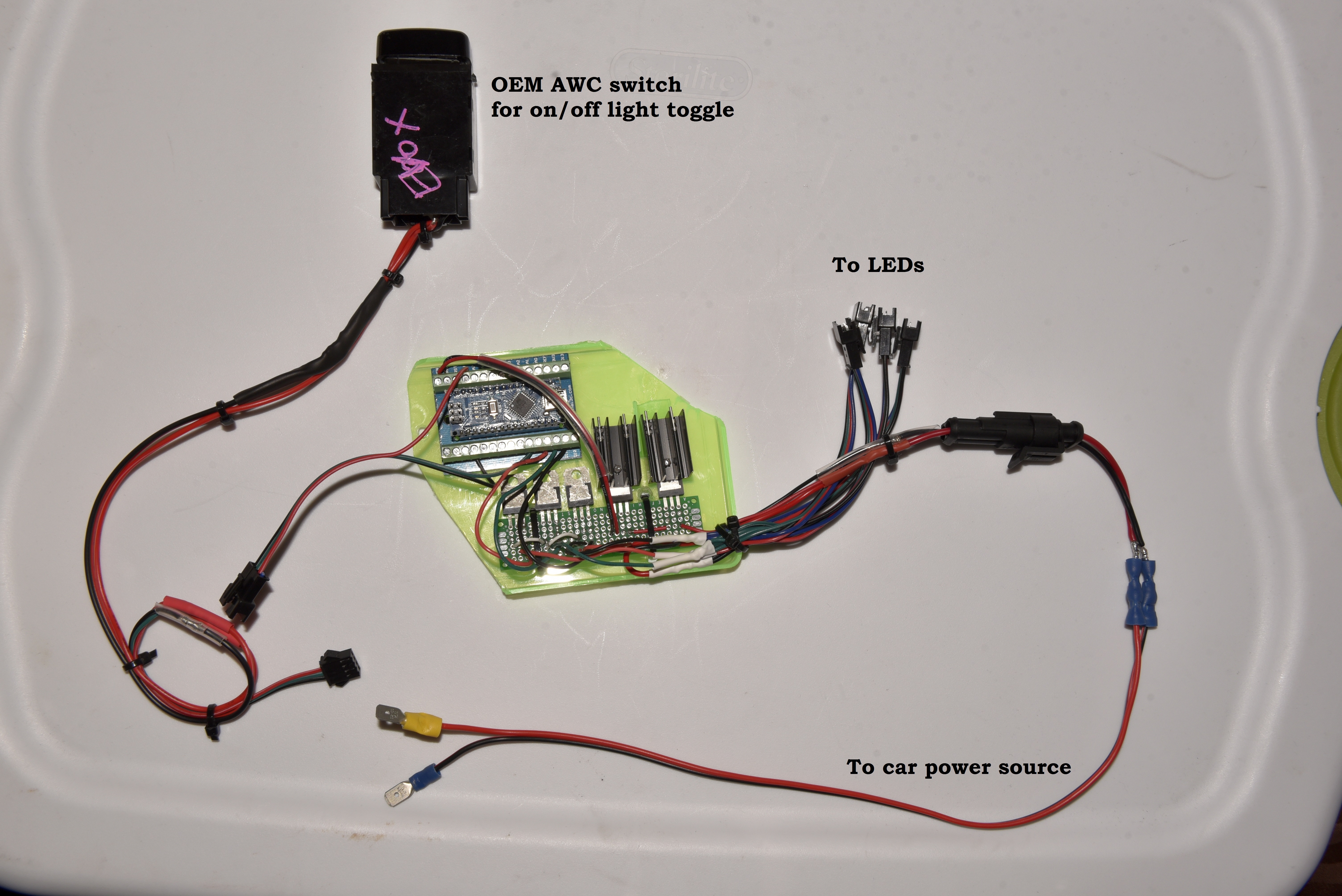

So instead, I looked into using an Arduino. It's a neat little programmable chip with lots of inputs and outputs. This little device allows you to program it any way you want, to have any number of states, and to pick and choose the color, intensity, rate of change, etc. It's really awesome.
This is the module I came up with in the end:
You can see the OEM switch on the left, the 4 LED connectors for each corner of the car, and input power from the car.
Here's a closeup of just the board:
Basically, what happens is that power comes in from the right, and goes through a 9V regulator to drop 12-14v to 9, then a 5V regulator to drop it down to 5, which is what Arduino runs on. An Arduino could handle more, but I've read they could get fried, so I played it safe and dropped it all the way down to 5V. The large black things are heat sinks to dissipate the heat of dropping the voltage.
This 5V will power the Arduino nano itself.
The main meat and potatos of this little device are the transistors. Since the Arduino can only output 5V and it cannot power the LED modules, what I had to do was to feed the full 12-14V to the LED modules. But to control the color as well as the brightness, I still need to control the voltage going to the LED modules.
This is where the transistors come in. They are pretty much valves. You connect input to one pin, output to the other, then a signal wire - the arduino - to the third pin. The Arduino then does things like controlling which of the R/G/B colors will be sent, as well as any Pulse Wave Modulation: this is how you make LEDs brighter or darker, by very quickly turning power on and off, or leaving it on for full brightness.
I'm not sure if much of the above makes sense, it's something you just go through if you're interested enough.
As far as the physical connectivity, here is how I installed the module and LED lights:
I velcroed the module to the side of the center console, on the left of the shift lever. Obviously I made sure no wires would come close to the shift linkage, so lots of use of zip ties and velcro straps.
For power, I spliced into my Axxess harness for the Pioneer 2din radio, and a grounded screw:
I can still take everything back to stock with no sign of anything having been installed, which I like.
The LEDs came with double sided tape, but I used my own 3M tape. If they fall off, I might use hot glue. The camera was literally on the seat. They aren't visible when sitting normally.
