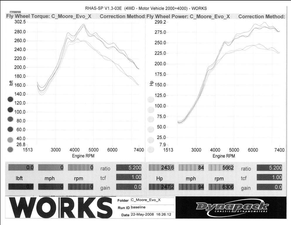

Just wanted to post a recent dyno graph from an EVO X P2 Flash.
This is a before/after. The car came in with a drop-in filter and bolt-on muffler.
This is a good representation of what we've been seeing from our flash, although we have seen steady improvement as the flash gets further refined.

Hey look the signature W power curve carried over to your X flashes too. Sweet

Yup nothing changed, someone paid $600 for that too.

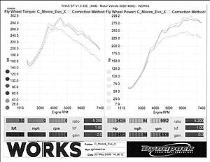

Dont know if this is me or not, but here is my dyno chart. I had WORKS do this 5/22/08. Mods so far are WORKS drop in Filter and HKS axle back exhaust. I am very pleased with the results and would highly recommend this for anyone. My car was on the dyno for about 7 hours. For $600, you cant beat the service and effort put into this tune. Peak boost ended up at about 25 psi and tapered down to 18 at redline.

No offense, but the whp looks low, and your torque seems to kick in about 1,000 rpm late. I have 200 ft/lbs of torque around 2,000 rpm, yours around 3,000 rpm. I've included my dyno graph tuned from RRE on dynapack. I saw another vehicle with just catback and filter, he made around 330 whp, and his baseline was 248 whp on dynapack.

No offense taken. My car only has an axle back exhaust. That could explain some of the difference. As for the rest, my A/F was very conservative. probably somewhere closer to 11 to 1. I only have about 4000 miles on the car, so we chose to go with a little less power and boost. Also, you can also see that my car only made around 240 whp baseline. So I already started 40 whp lower that you. If you look at the gains made, they are pratically identical. Peak torque and peak horsepower are at around the same rpm. You can never look at the horsepower numbers on two different dyno's and exect them to be the same. But look at the gains. I see you gained about 50whp and 35 wtq, pretty much the same as me.

My base line had FMIC, Test Pipe, Exhaust, Intercooler Pipes, Intake, etc. My stock base was around 240 whp., 280 with Mods, 350 whp with Mods & Tune. So the total gain is 107 whp. We're comparing with same type of dyno, "dynapack" It peaks around the same, but your car needs additional 1,000 rpm to get to 200 ft.lbs of torque. Do you have AFR graph? My car was tuned very conservatively for Tracking.
My car gained more than 70 whp with tune, you've gaine 45 whp. I don't see how that's the same.

umm... different mods?

Mike@ RRE tuned a car with just a catback and drop in filter, and the car is putting more than 330 whp on dynapack (same dyno Work is using). That's almost 90 whp gain. I don't think it mods, it's the tune.
