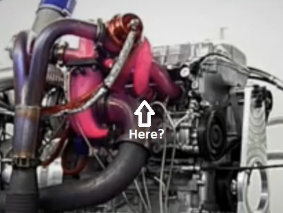

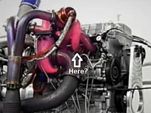

Where is an EGT probe typically installed? eenie meenie miney mo, in this header runner it will go?
I saw exceptionally hot runners coming from the middle two of a tubular manifold, so maybe pick one of the two?
