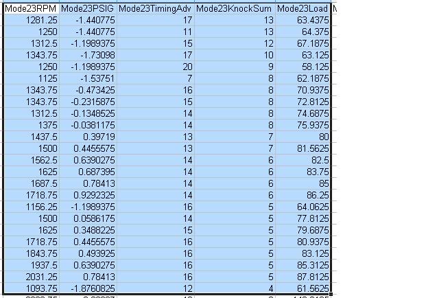

So this isnt anything to worry about then?

Is it repeatable or random? If not random it's something that needs to be looked into more.
