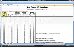

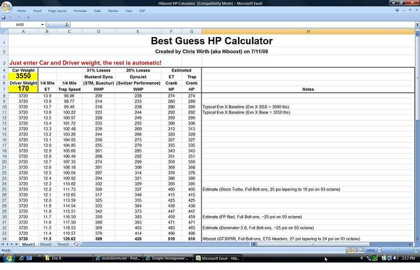

Many of you have likely seen HP Calculators like this online:
http://www.dsm.org/tools/calchp.htm
About a month ago I made a quick spreadsheet based on that formula and all you need is the current weight of your car plus driver entered in the upper left corner.
The spreadsheet takes care of all the rest of the work and should offer a good "best guess" of where your HP levels are based on ET and Trap Speeds at your current weight. Factors like running out of 4th gear through the traps, better or worse than average 60' times, and increased Aero drag at higher speeds will throw things off but it's still a good rough estimate.
The general rule of thumb is every tenth gained at the 60' will reduce your ET by 2 tenths. The ~10 HP per 1 mph trap speed is also a good general guidline.
Hope it helps!
