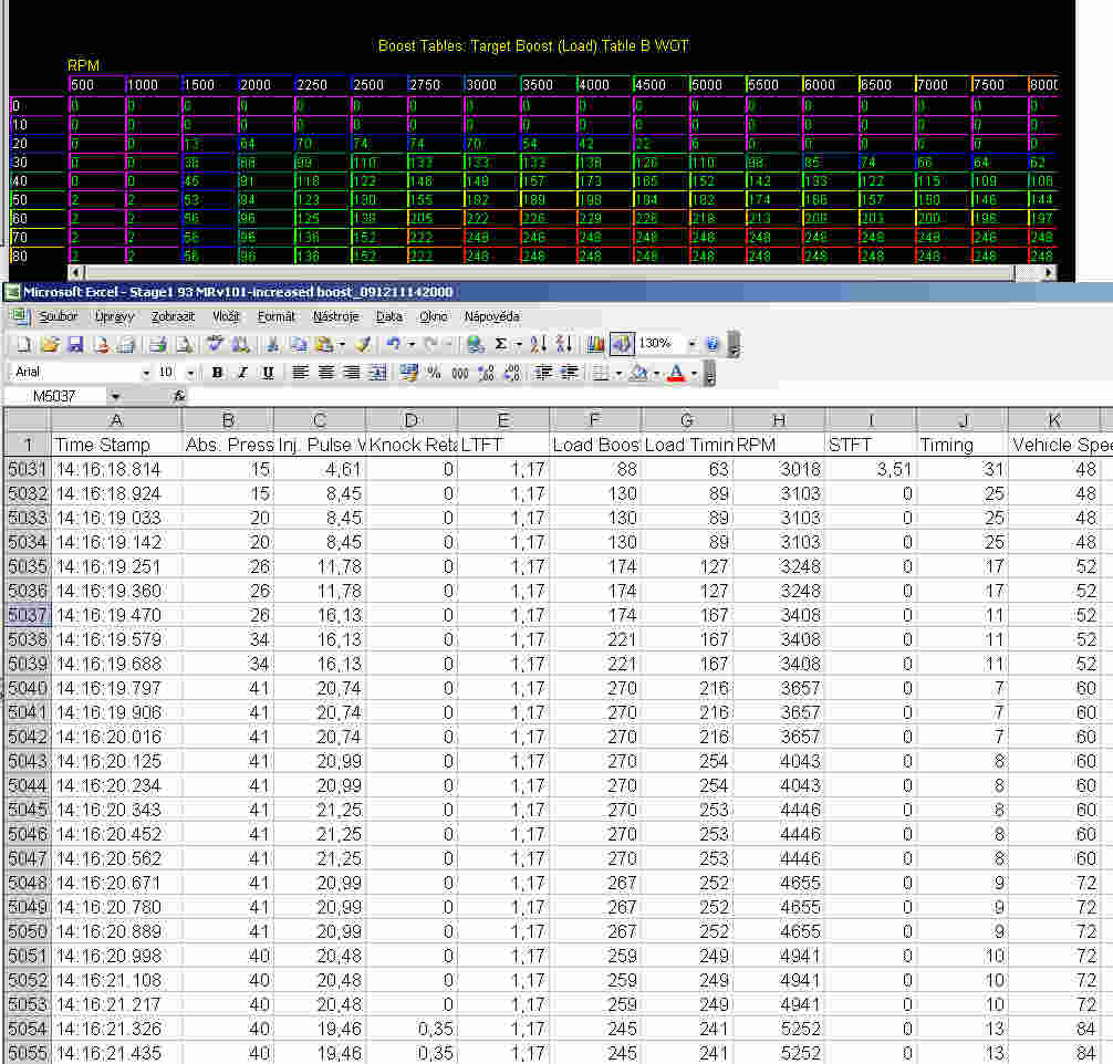

I lowered all the 3 boost tables to max 248 target load, but if you look at the log of 3rd gear, I reached 270 load at 27 psi and the engine did not go smooth, it was like a few fuel cuts or any other tq limiting during the pull.
What am I doing wrong?

Seems to be the same, but load I reach is much above target in tables..
