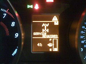

this is exactly what popped up after the clutch install

edit: just checked the reservoir tank in the trunk and almost empty, heading now to the dealership to get some atf sp 3

just got back and it worked $10 for a quart
gotta love EVOM
