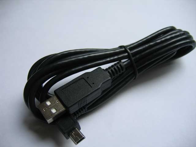

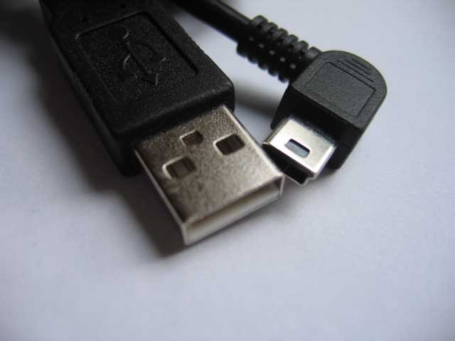

Right-angle USB cables help prevent snags that can rip the cable out of the tactrix dongle and/or the dongle out of the OBD port. After ripping my Tactrix out a couple times I went looking for a solution and remembered hearing about other people using these.
ebay:

the fist one is misteriusly simular to my Tom Tom USB. LOL
