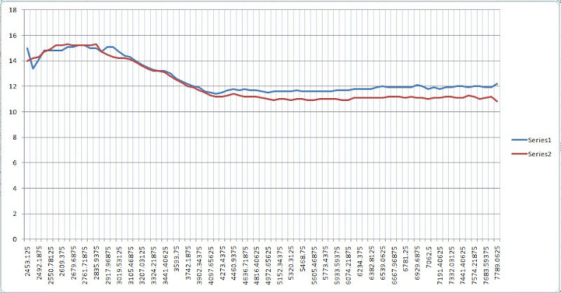

Here is a screen shot of two runs performed 10 minutes apart. The ONLY change is that I added 3 gallons of fuel to the tank.
Tank was 1 bar below half tank, WB02 started reading lean....I added 3 gallons and that put me 1 bar over half.
Here are the results:
Is this a fuel pickup issue or the walbro getting hot, then cooled down my the additional fuel? Anyone else see a "0.8" difference when they fill up?

interesting, keep us posted. same octance? same gas station? same time when you got the fuel or the 3 gals u added was in the can sitting down for a long period of time ? afaik, 1/4 tank of gas the fuel pump is still fully submerged with fuel.
Old Oct 29, 2010 | 08:12 AM
fostytou's Avatar
EvoM Community Team
Posts: 3,143
From: Aurora, IL
You are sure it was the same road, same spot, same throttle? Did you hit the same load cells? Same gas station within a days time?
Might be more scientific / repeatable to do something like driving till almost empty, filling up 5 gallons short and filling a 5 gallon jug, doing a pull with it in the car (to make sure the weight doesn't change), fill up, drive long enough for it to circulate, and pull again.
Seems like alot of work, but I think a change in wind, weight, fuel quality, or one of any number of reasons is cause for change (of load cells or physical inputs). I think there are probably too many factors here to rule it fuel quantity.
It would also be helpful if you could reduce the scale on that chart so we can see the difference easier.

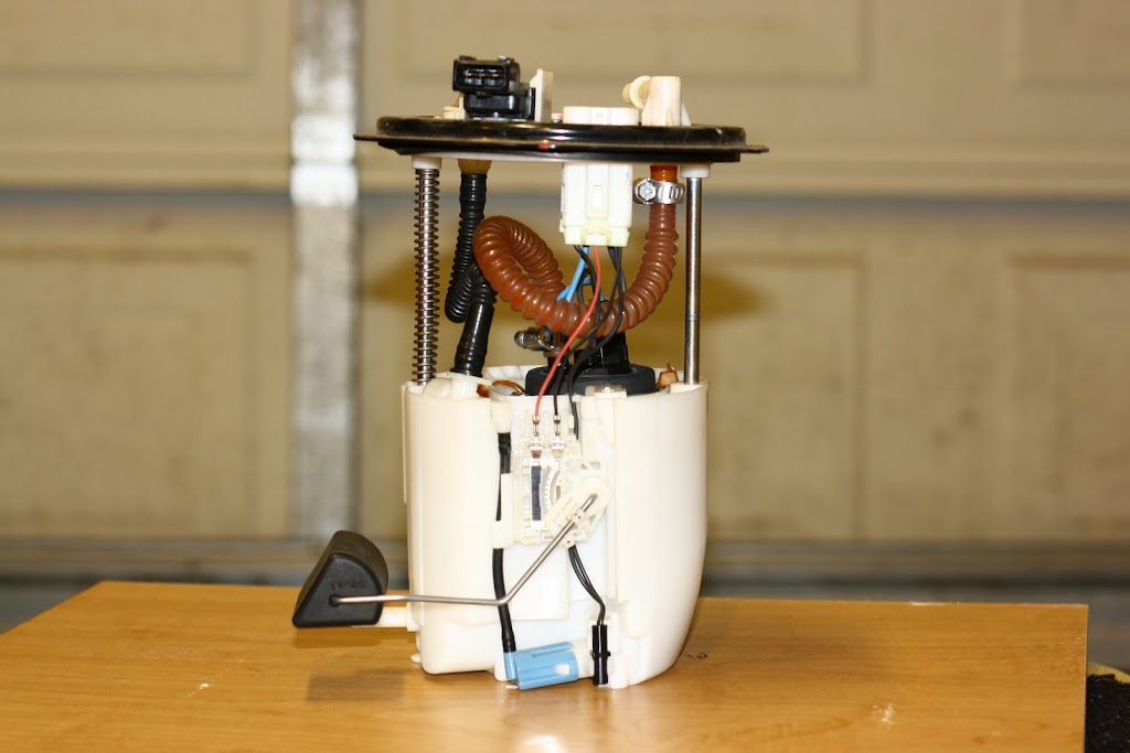

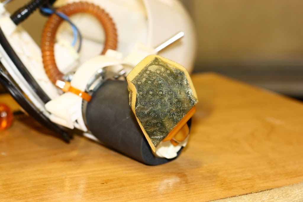

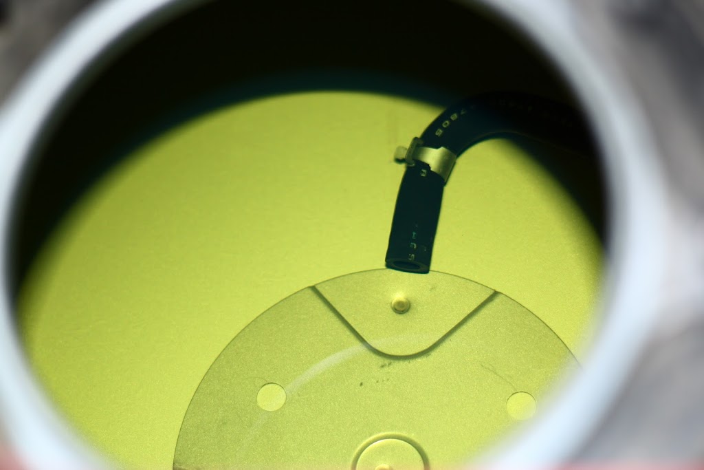

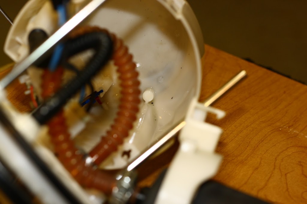

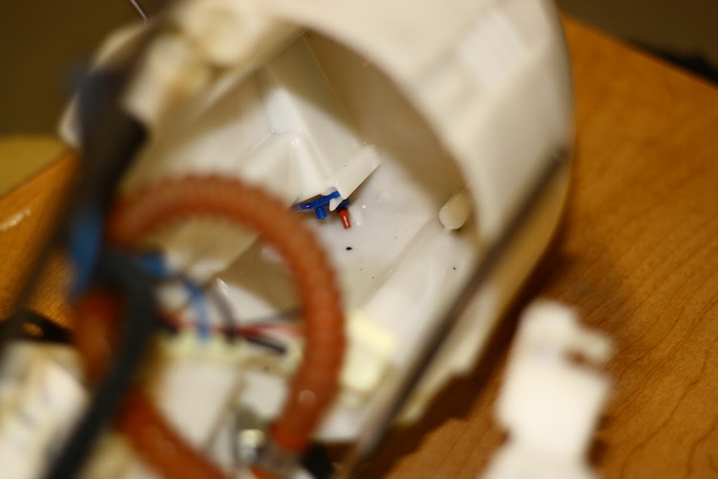

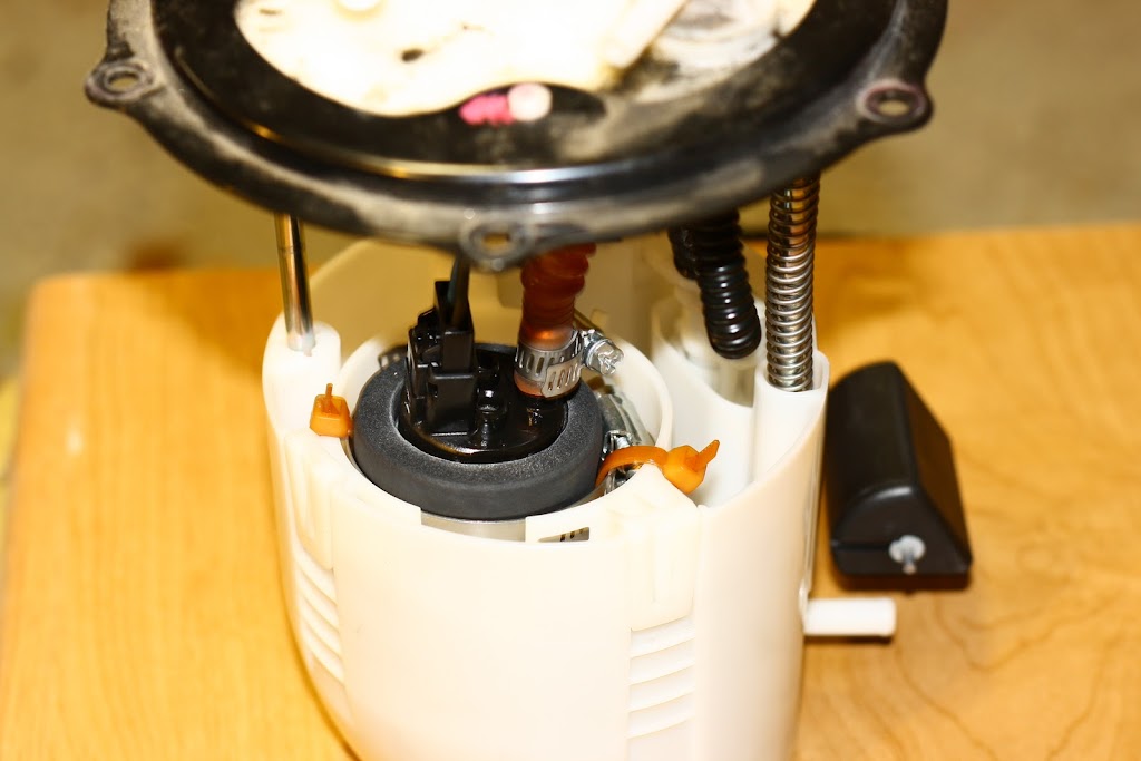

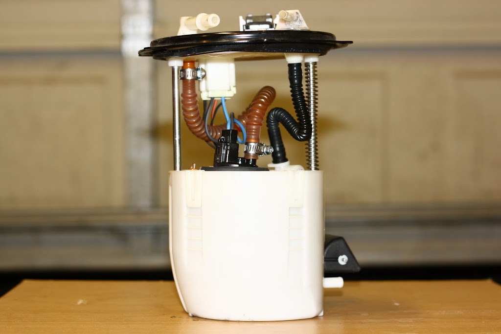

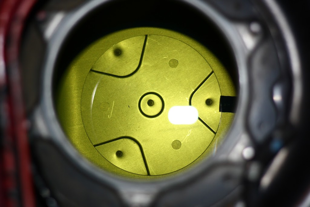

Here you go guys....some pics of the setup.

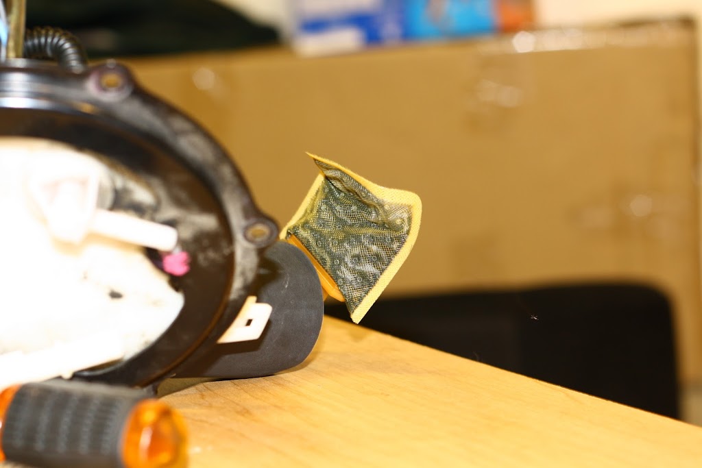

I noticed that the hose clamp that holds the pump itself loosened enough to allow the pump to sit on it's filter sock. I don't believe that to be a problem, but will readjust so that the filter sock sits just above the bottom. DO you guys think that could have caused fuel delivery variations?
Also please notice all the black debris in the filter sock and the bottom of the fuel pump housing cup...
Is it normal for the filter sock to look this dirty in 11 months? Is this just charcoal elements I'm seeing or dirt from the gas stations?
pics below
This hose clamp was loose, allowing the pump to sit on it's filter sock...
Should the sock be this dirty in 11 months?
Notice the black debris in the housing...normal?
Tank looks clean, maybe the black debris from the filter itself (charcoal)?
Ideas guys?

You run pump gas right? Is ethanol in it? Those hoses look like what E-85 does to plastic. Your hose clamps look the same. The black crap could be that foam thing falling apart from Ethanol.
Old Nov 1, 2010 | 09:05 AM
tsitalon1's Avatar
Posts: 2,072
From: Southeast USA
Nope, 93 octane only!
But keep in mind, most gas stations use 10% ethanol in gasoline, so the color change didn't really alarm me.
The foam spacer looks new...

Yeah, I never really heard much after TTP stated this....We hear alot about the hard left fuel starvation, but rarely do we hear how the fuel level in the tank affects normal straight line acceleration.
My best guess is that the pump shifted to low in the housing preventing fuel from coming in on the underside of the filter sock....I'll probably raise it an inch and see what happens.
