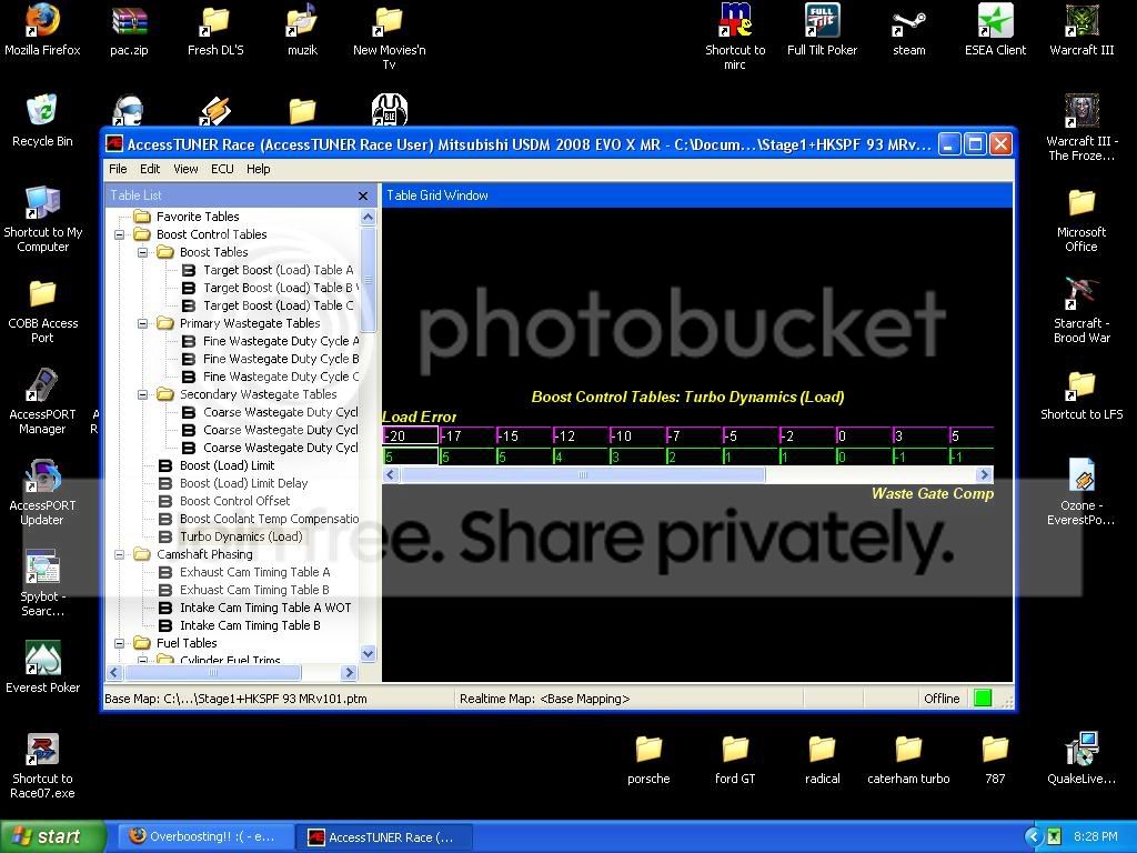

Put the stock pill back in. That will lower your spike. If that does not work, you will have to zero out the the -20 load cell in the turbo dynamics table, aka, Turbo Boost Error Correction table. The -20 load cell has the number 5 in it. Set it to zero. That will cure the spike.
Edit: I just looked at the map your using. The target load/boost is way high. Cobb set the target load map A, B, C at 250, 252, 249 at peak boost @ 3500 rpm (In ECUflash these tables do not go higher than 159.4) But that is too high because the target load map is added to Boost Control Offset set at 100. So now the total target boost is 350, 352, and 349, unless in ATR the BCO does not add to the target load map.
Your car on stage two is probably hitting 250 load cell at peak boost load. The map in the ECU is demanding 349-352, assuming that in ATR BCO is added to the target load maps. So your off by a factor of 100. The ECU looks up the turbo dynamics table and adds the maximum 10% to the WGDC causing higher boost.
Again, I am assuming that BCO is added to the target maps as it is done in ECUflash. If BCO is not added, then the target boost in the maps is really good and the reason for the overboost is the removal of the pill and load cell -20 not zeroed out.

Then you will have to zero out the -20 load cell in the tubo dynamics table. It has a 5 in it. Set it to zero and log and see what the boost is. I am assuming that you have an Access Port that allows you to edit the maps.

So you're saying I should change the -20 cell to 0? Is this the proper area you speak of?

yes thats what he's talking about.. make that -20 cell 0 instead of 5 and go log

remember to use the map conversion tool from cobb after you edit the map before you load to your ap
