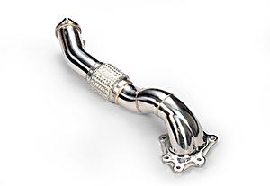

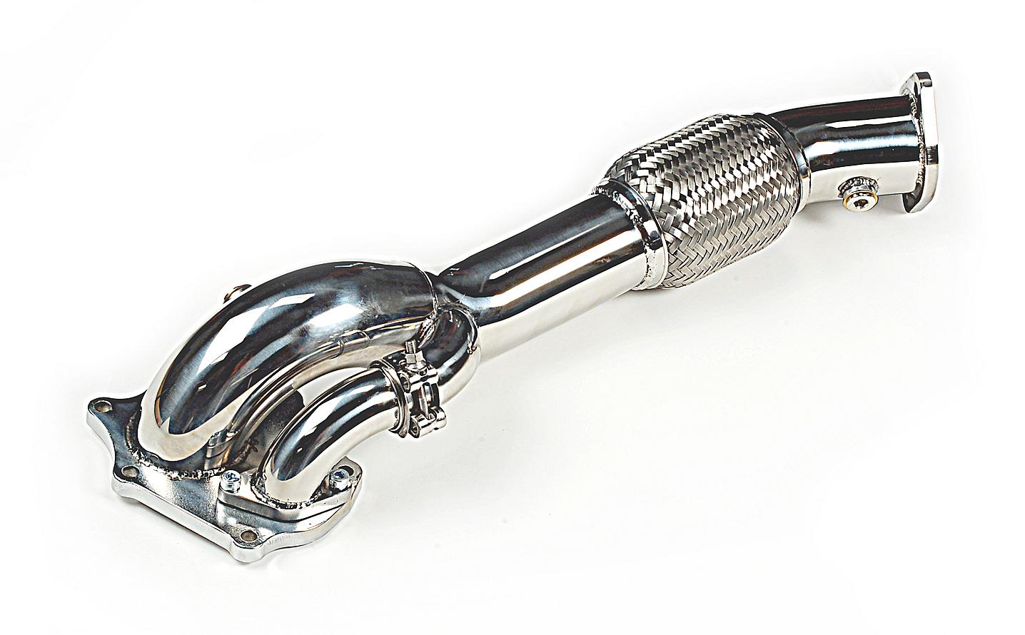

Hi guys...it may be a noob question, but can someone please explain the difference between a regular downpipe and a widemouth downpipe and what are the pros/cons of these two?
Regular Downpipe
Widemouth Downpipe

Both of these designs are for the stock frame/ internal waste gate turbos. The lager pipe on the "regular" downpipe is the turbine exhaust and the smaller is the wastegate dump tube. On the "wide mouth" down pipe the two exits have been merged with a larger single exit which is more like the factory housing. The wide mouth design will allow more flow, but possibly have more turbulence. When I was on the stock turbo, I used a wide mouth downpipe.

So, are you saying a divorced downpipe would flow a little less overall, but be smoother? I don't know if the extra smoothness would even be noticeable, or cause the turbo to spool any faster.

They're all 3" so the flow limits will be about the same. If anything, additional turbulence will reduce the flow.

A 'regular' downpipe divides the turbine outlet and wastegate outlet into two separate paths, which then merge further down the pipe. A 'widemouth' downpipe merges the turbine and wastegate outlets immediately out of the turbo into a single pipe.
The widemouth will be simpler and more compact, while the divided outlet will have better flow and less turbulence. If you're worried about getting every last horsepower out of your setup, go with a divided outlet downpipe. If you're looking for something that will still make good power but is probably a bit less expensive, get yourself a widemouth downpipe.
