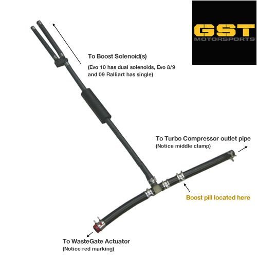

So went out and checked using the diagram and immediately noticed the dual boost solenoid lines are just completely missing (with one being cut like i mentioned)....seems to make a lot of sense now

Lol agreed, do you know where I can buy a complete kit to replace it like in the diagram or just build from scratch? Seems like a lot of places cater more to the STi these days.
