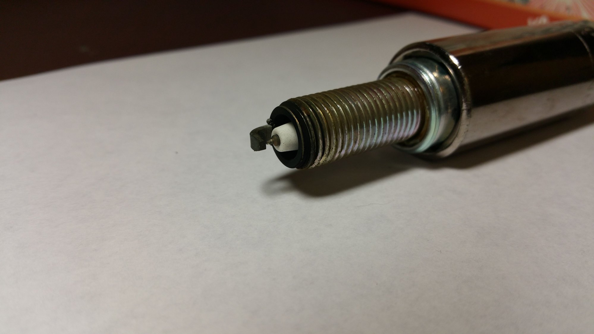

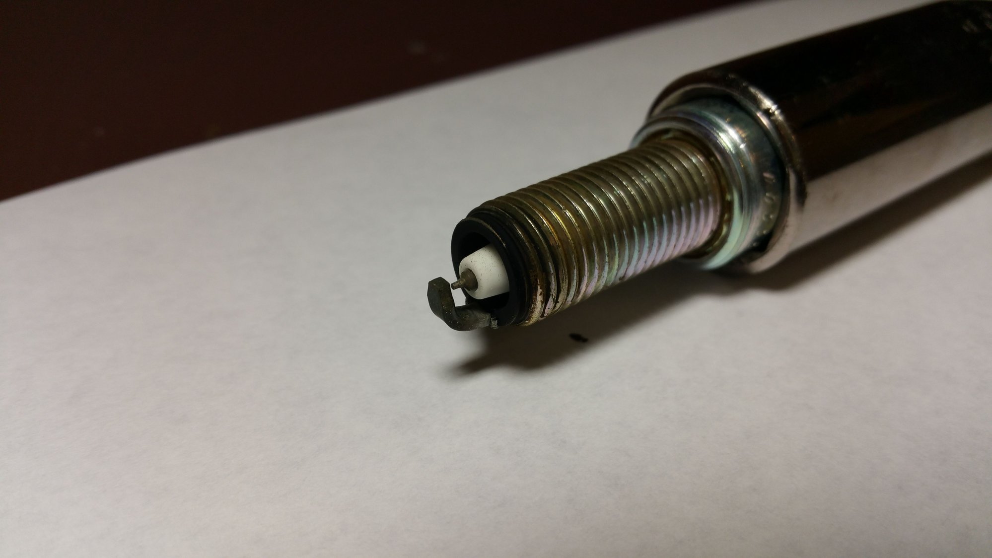

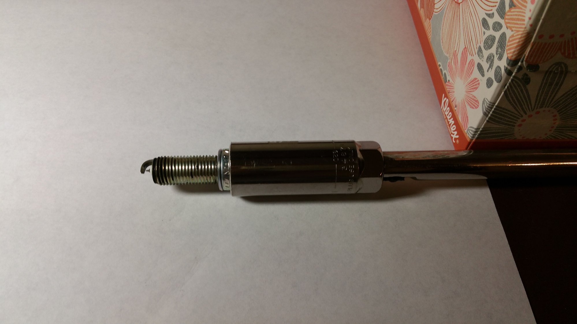

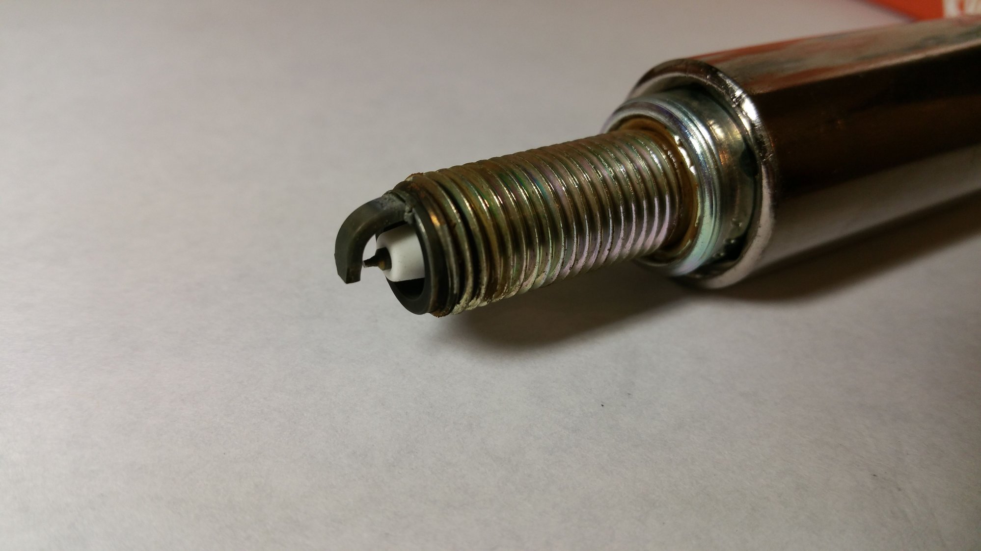

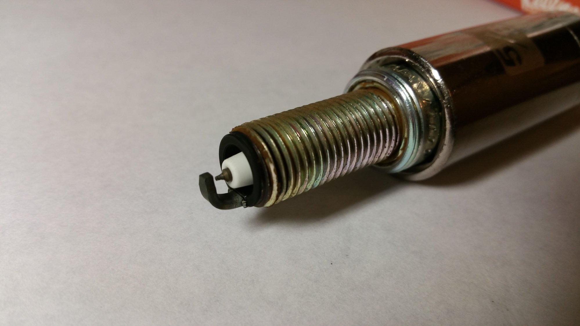

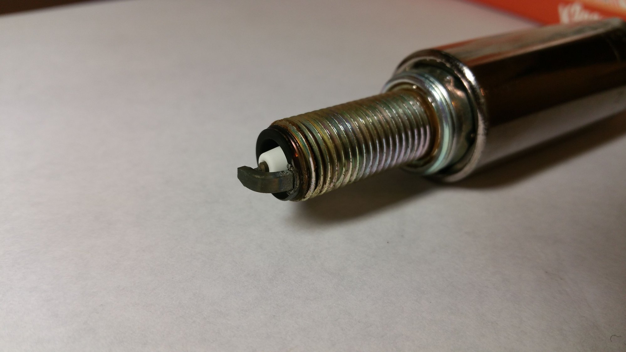

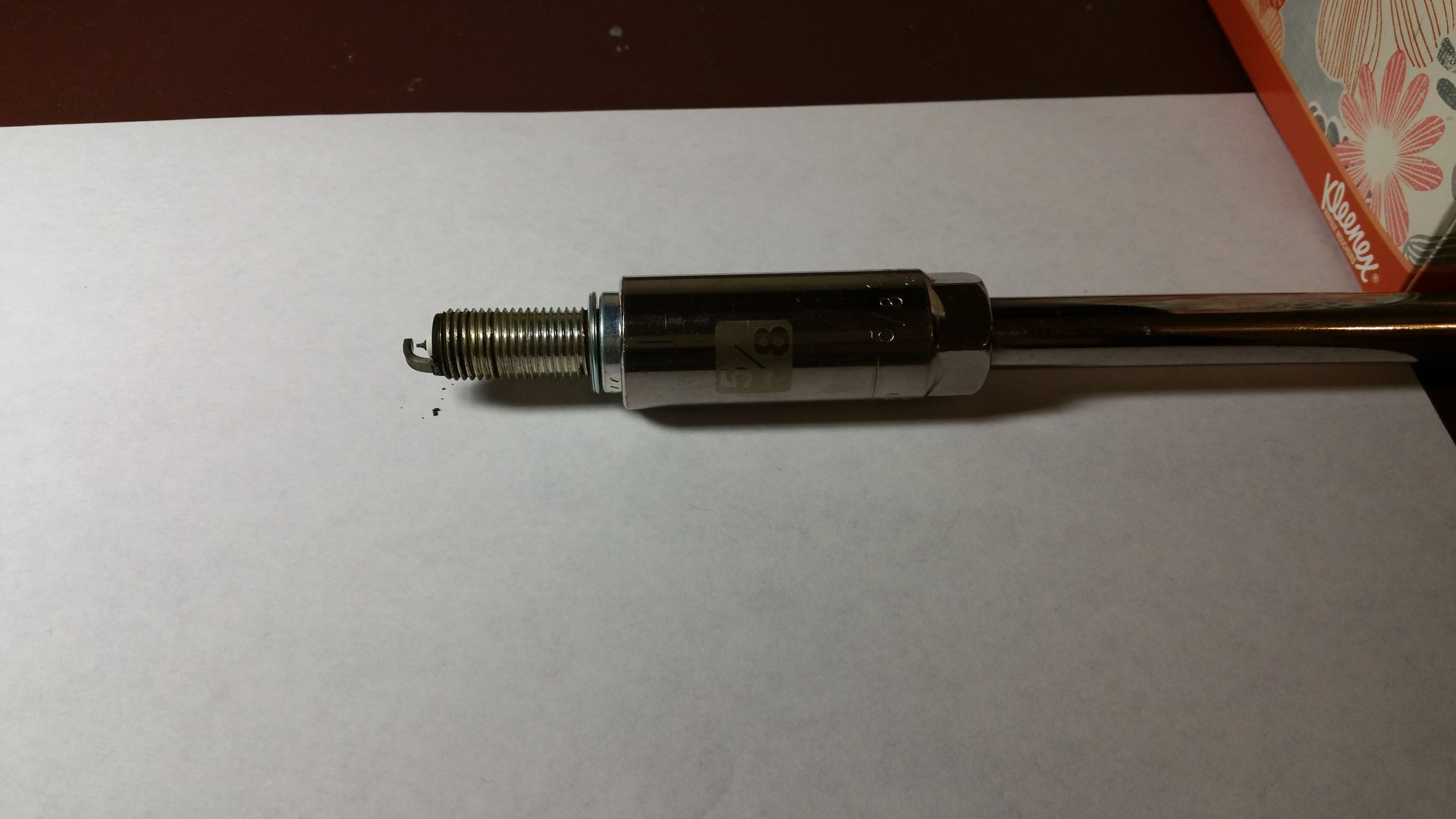

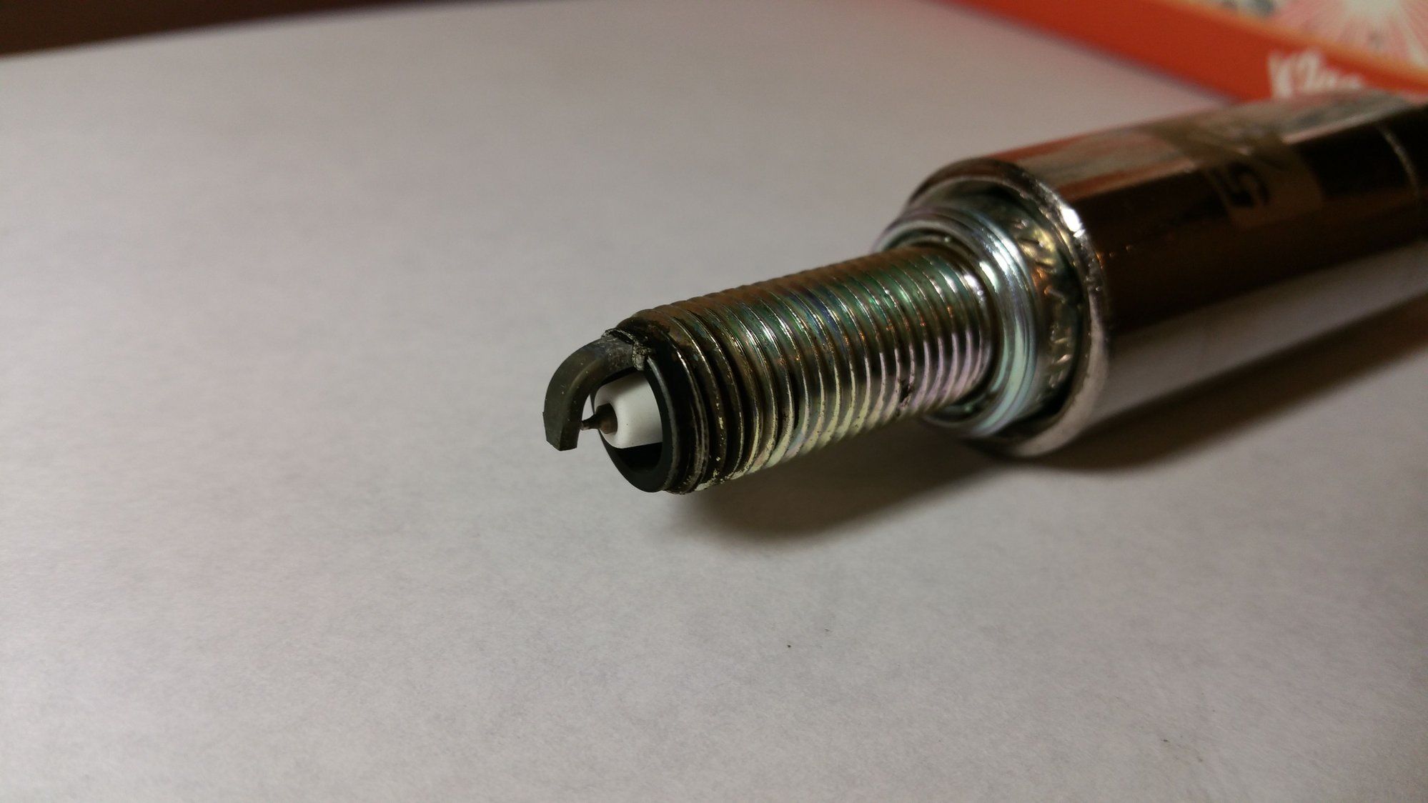

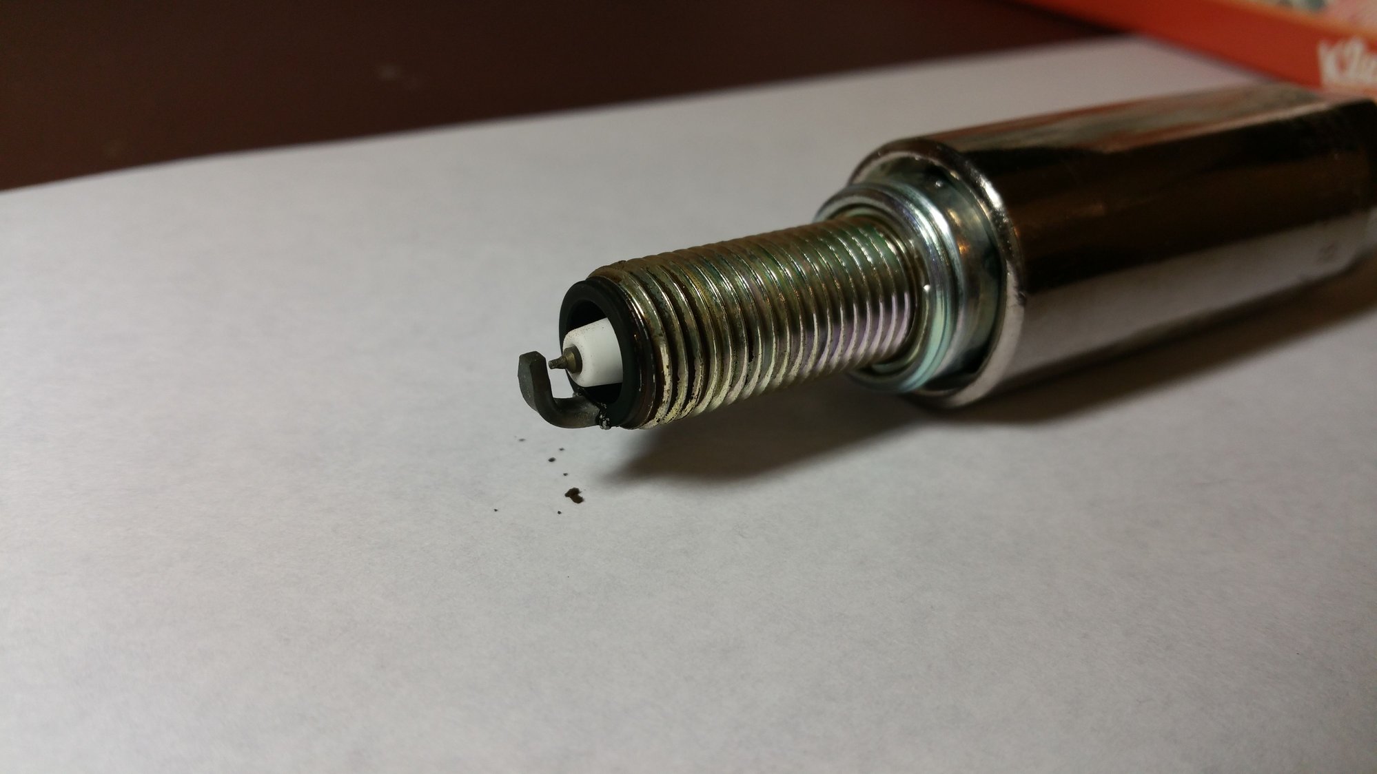

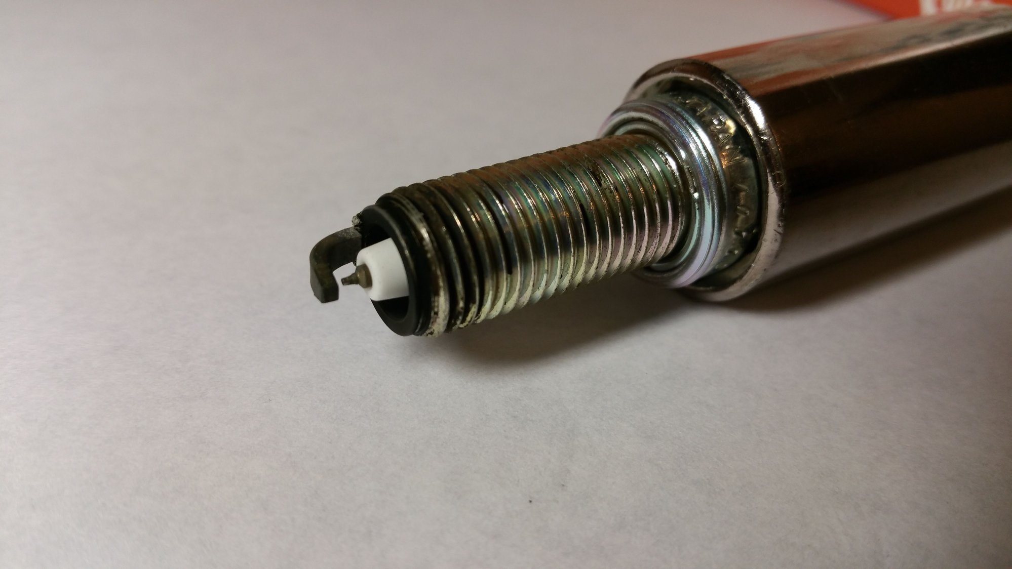

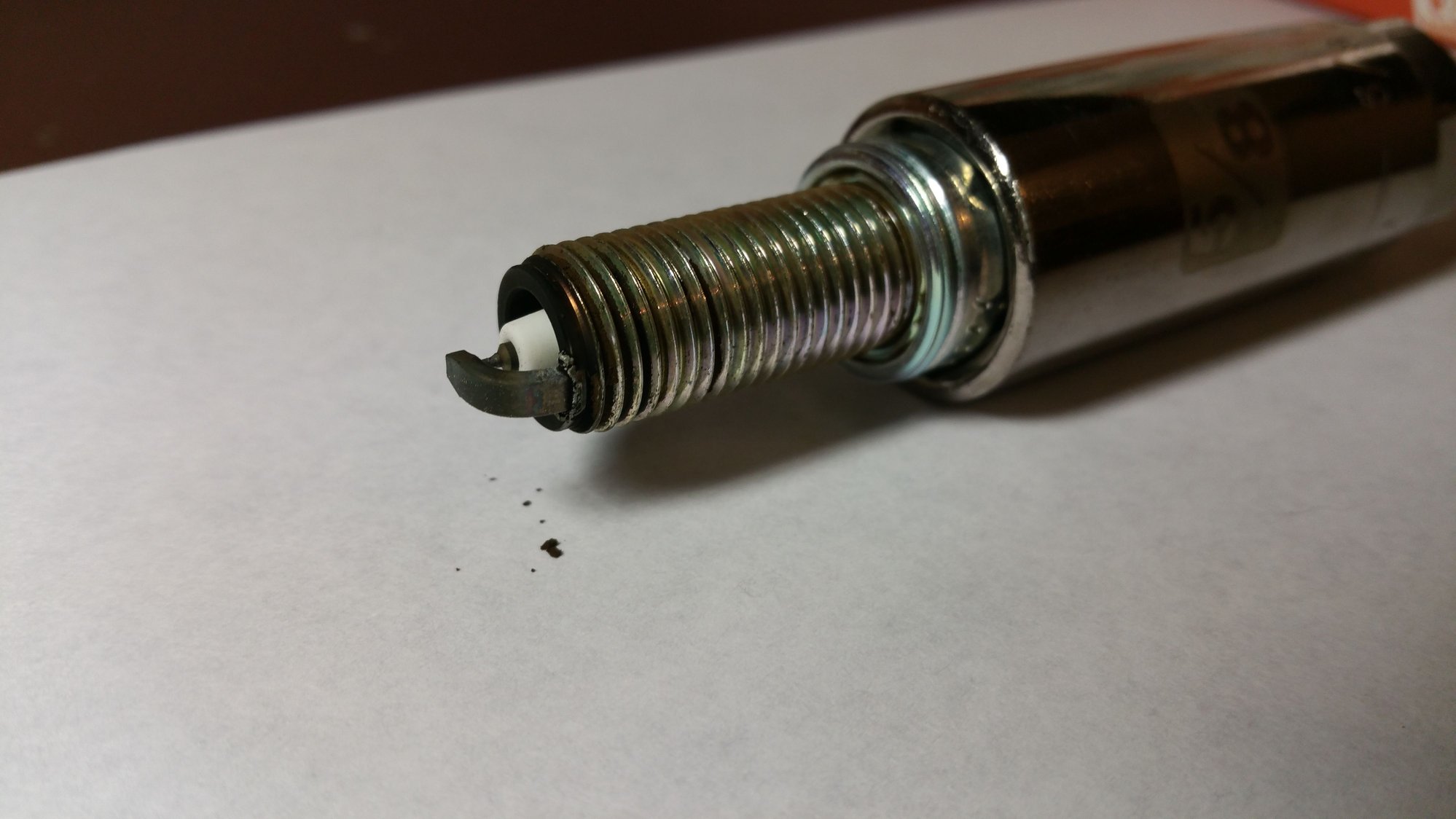

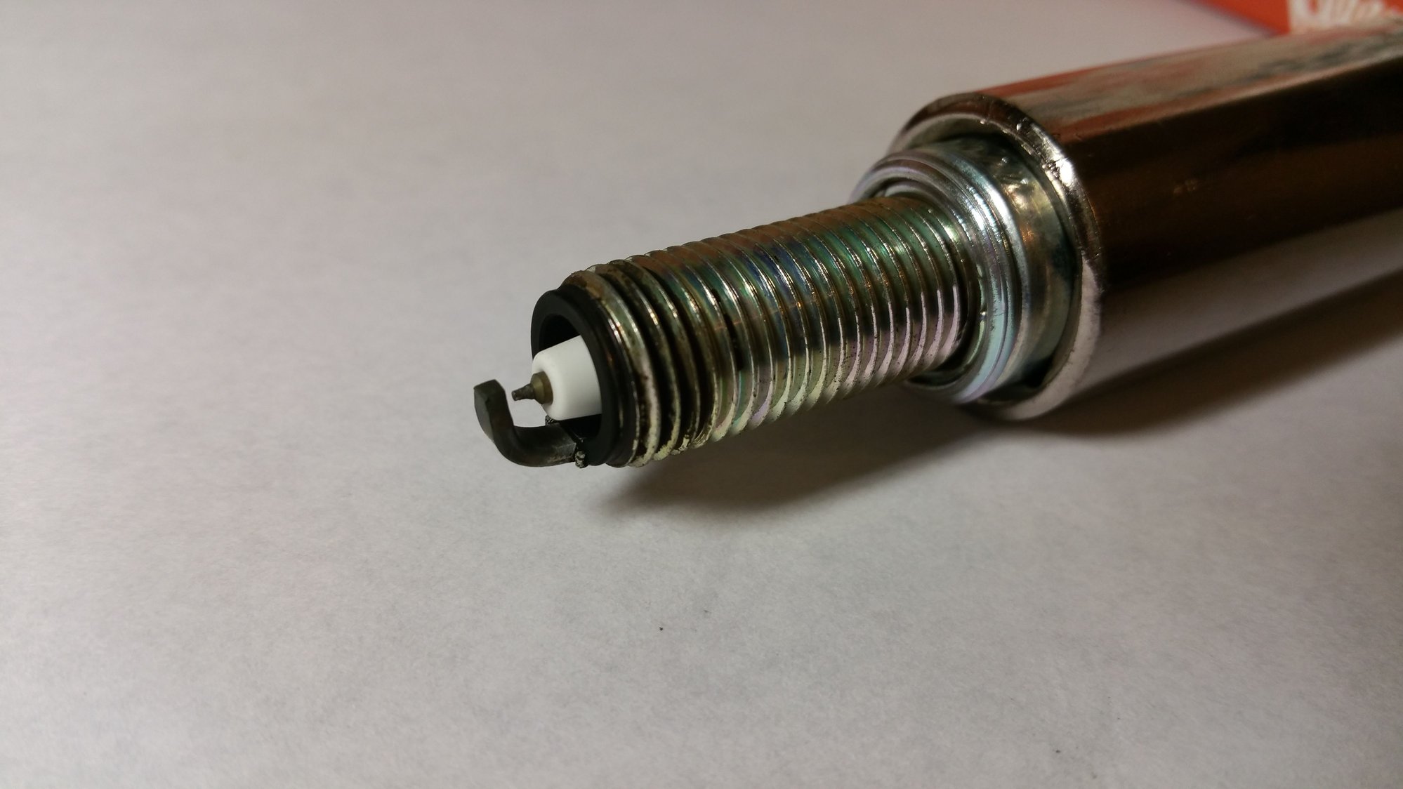

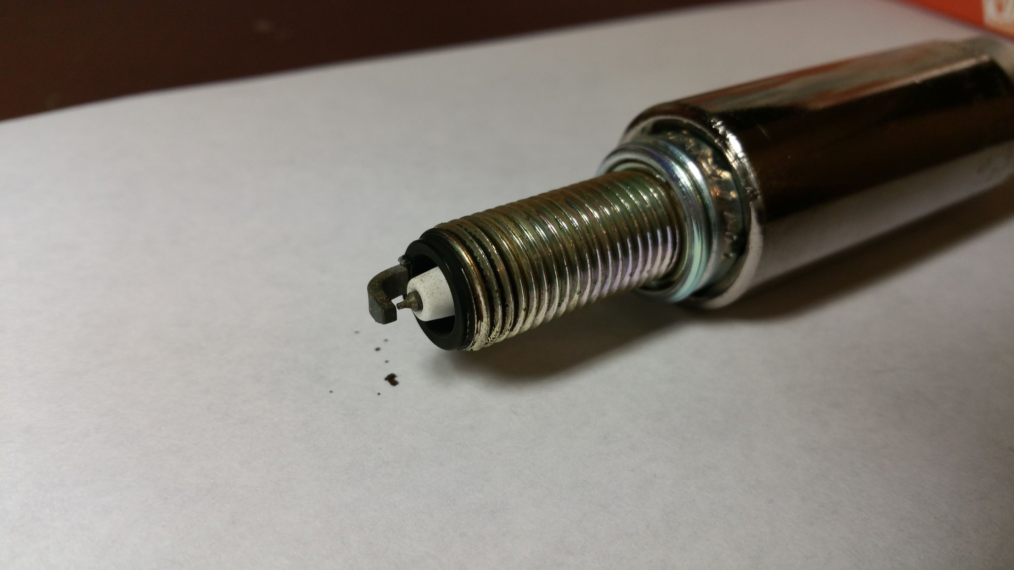

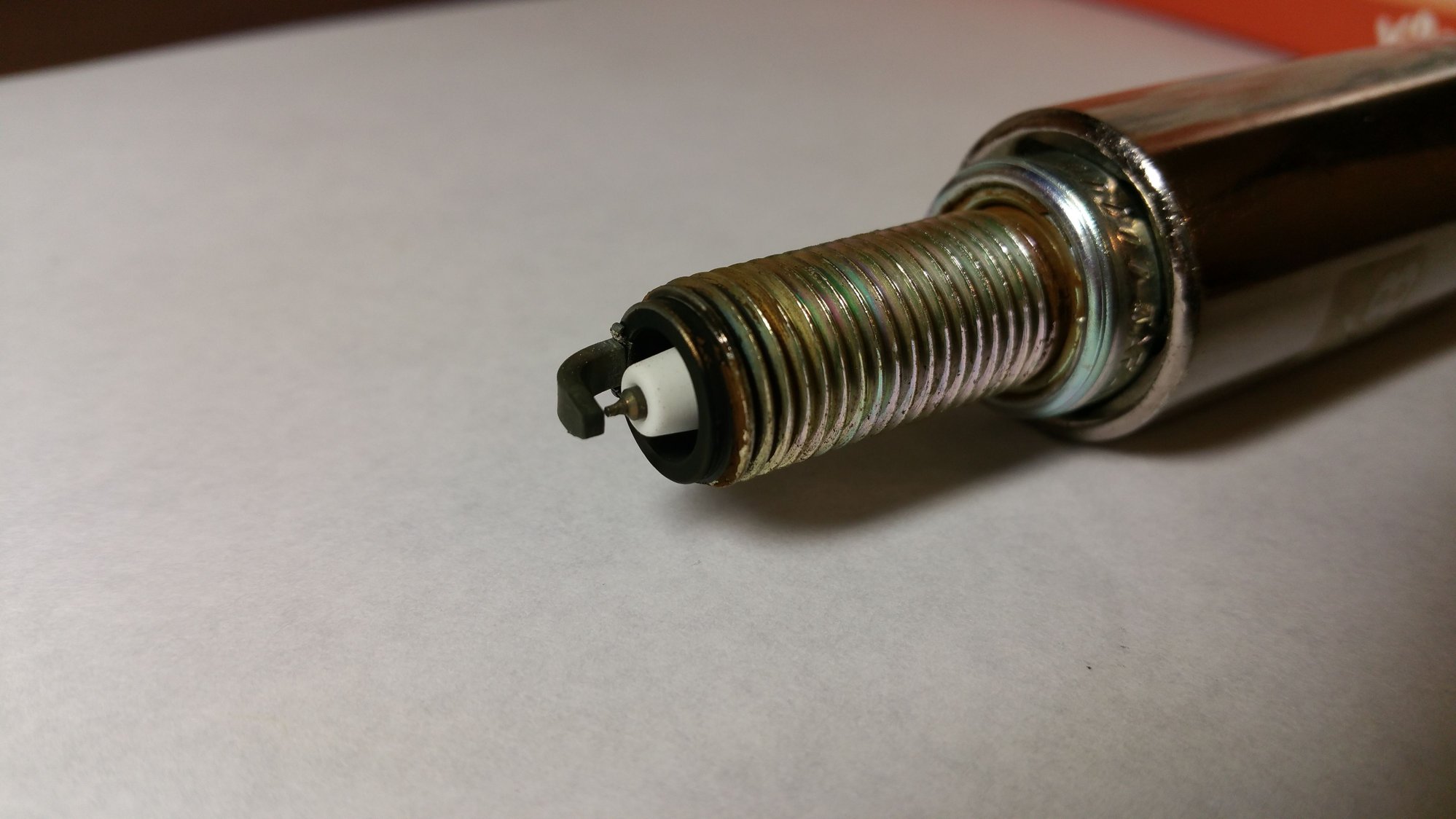

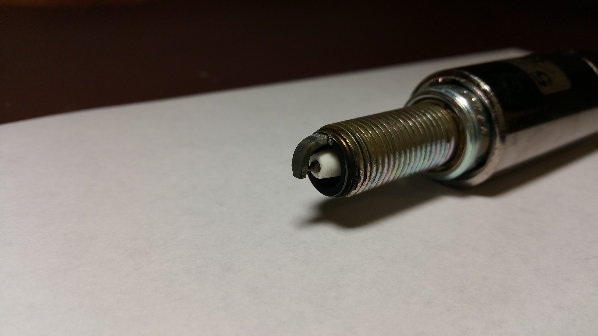

I just went and took pictures of the spark plugs. They were pulled out after the car had cooled down from being driven normally. I was wondering if you guys can take a look at them and tell me what you think. I'm not very good at reading plugs. It kind of looks like the engine is detonating from the specks on the insulator and also colder plugs are needed because the electrode plating is burned past the curve to the vertical portion.
Also, if assuming its not caused by the spark plugs, what should I check next after cleaning the throttle body ? Spark plug gap and compression test ?
Cylinder 1
Cylinder 2
Cylinder 3
Cylinder 4

Your plugs look ok... I would suggest hitting up Cobb and seeing if they can take a look at your tune. There might be a little hiccup in the tune.
Evol Xenius, thanks for your response !
I got a chance to drive the car late last night and the misfire at idle was gone and so was the p0300. I'm not sure what happened. The only thing I did was take out all the spark plugs, take pictures, and put them back in. The only difference is that this time I torqued the plugs to 13 ft lbs instead of 10 ft lbs because since the washers were already crushed, once the washers contacted, the torque wrench clicked and I was afraid it was too loose so I set it to 13 ft lbs to thread it in like 5-10 more degrees.
Maybe its actually because my spark plugs weren't torqued enough ? I will see if this problem comes back. I'm also still going to do a compression test to find out the general health of the engine.
