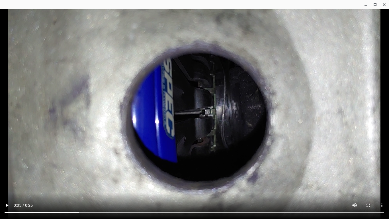

So i still havent solved my problem. I did manage to pull my skid plate and look in through the inspection hole.
I was able to confirm that its using the ACT Monoloc, however, i have no way of determining the maker of the TOB. I can clearly see that the tob is still attached to the pressure plate release levers, and that there are no obvious signs of failure.
However, when i focused on the position of the wavy springs, i noticed that there was a gap between the monoloc and the levers on just one side. When the clutch pedal is depressed you can clearly see that its not pulling on the levers equally, causing the friction disk to only unclamp partially.
I tried to pull on the release fork, seeing if it would seat when i pulled it towards the slave. It did travel fairly easily, but it didnt really make any difference.
At this point, Im thinking something broke on the assembly of cages that are attached to the pressure plate levers, causing the tob to become misaligned.
Does anyone have any idea? Also, What is the specific name of the cages that attach to the pressure plate levers? I cant seem to find them anywhere. I just keep getting the monoloc/retaining collar. Are they only sold with the pressure plate? Do they come with a new tob if you order it from mitsubishi?

If I understand you correctly, the part you're talking about is part of the pressure plate. The center springs are all connected at the middle by the cage that the monoloc clips into.
You might be able to see a bit better what's going on if you get in there with a borescope but otherwise you're gonna have to drop the tranny to see the whole situation.

It's kinda rare... but I've seen the mounting points for the fork rod thingy break. I wonder if that's what happened to yours. That could explain why the fork doesn't seem to be pulling straight. It may be something as simple as the pressure plate fingers being messed up and not letting the Monoloc seat correctly. Either way, everything has to come off, so may as well get 'er done. It should be pretty obvious, once it's apart. I'd also recommend NOT using that brand of clutch.
