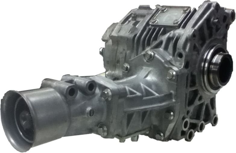

On top of that, my buddy found out that my tcase is leaking, mostly dripping but I guess that's what you call leaking. The dealership here in Hartford that installed my new motor left a bolt out of the tcase.
Now if you look at the image you will see a sandwich-type part with four corners at the bottom left of the pic. One of those is missing,
Now, I bought myself a bolt from STM and I hope my buddy can put that in just to see if it stops the drip, if not, maybe there's a gasket or I need to RVT a certain area. I was thinking of having the dealership do the fluids for the TCASE and let them know something is leaking. Maybe they can figure it out.

on that magnetic inspection plate, just remove all the bolts and reintall with gray rtv. let it dry per instructions and fill with fresh gear oil

oh wait. It looks like youre talking about the tail housing (not the inspection plate). That's actually sealed by a gasket. you can try to just loosen then retighten all the bolts and see if it stops leaking.if it leaks you need to get a new gasket, I believe you need to disconnect the front half of the propeller shaft to install the new gasket. its fairly easy. you're probably low on transmission fluid at his point so you should top it off
