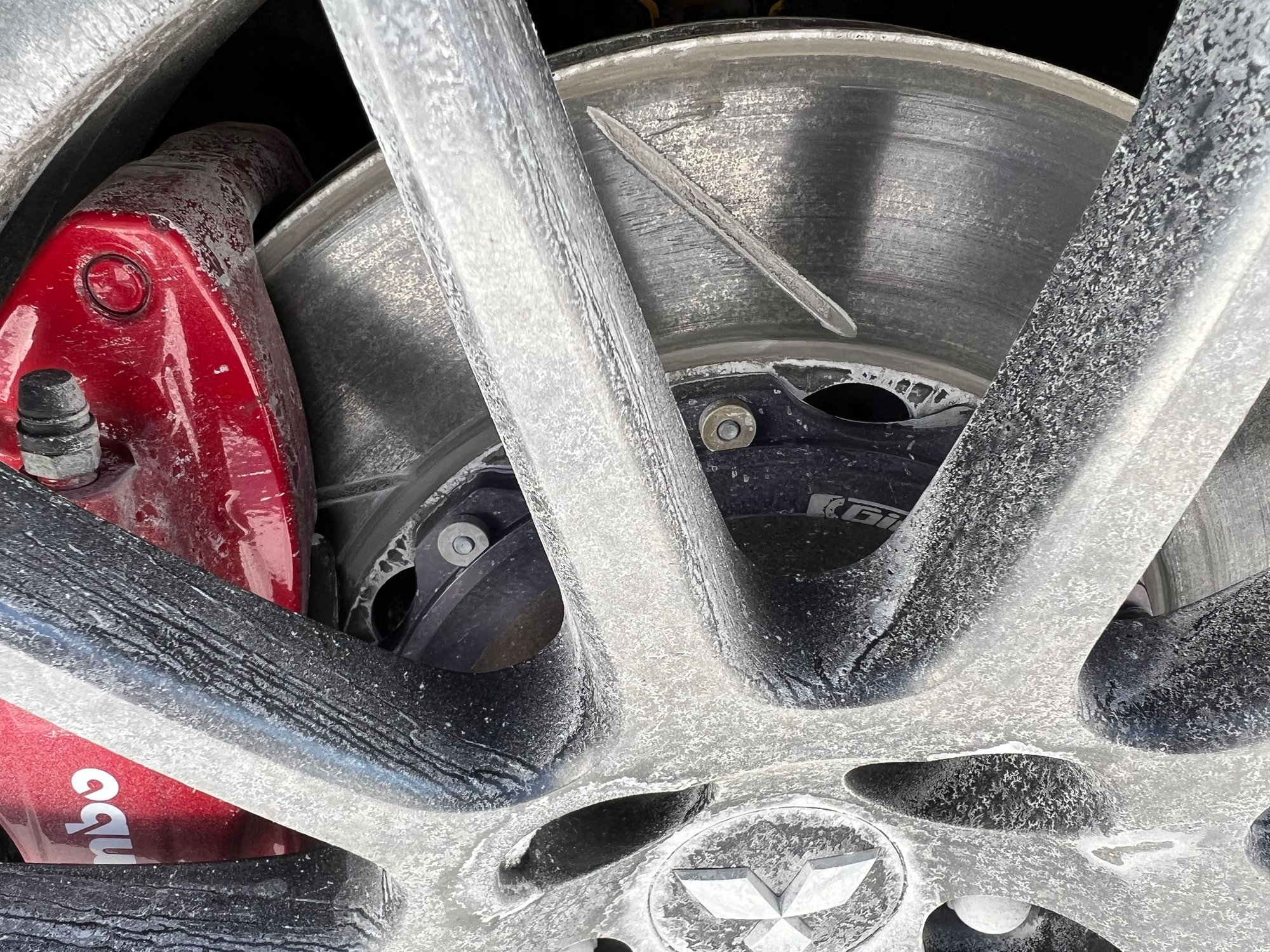

I had that on my 90 Galant VR4 back in the day, was t-boned and rebuilt however the door never sealed properly , I would still have that car today if it wasn't for that . Its unfortunately not that either , below 5mph its silent, and from 5 all the way to 100mph at 7krpm the sound remains the same all the way to 100 at 7krpm. its been so cold here and the driveway has about 2 inches of ice on it so I cant really do much. what's odd is when you first start out out it makes the noise then stops a sec then starts again. I did just notice that my 2 piece rotors, all 4 are slotted, at some point previous owner put on Girodisc replacements, soaking them good at the car wash did not make much difference.

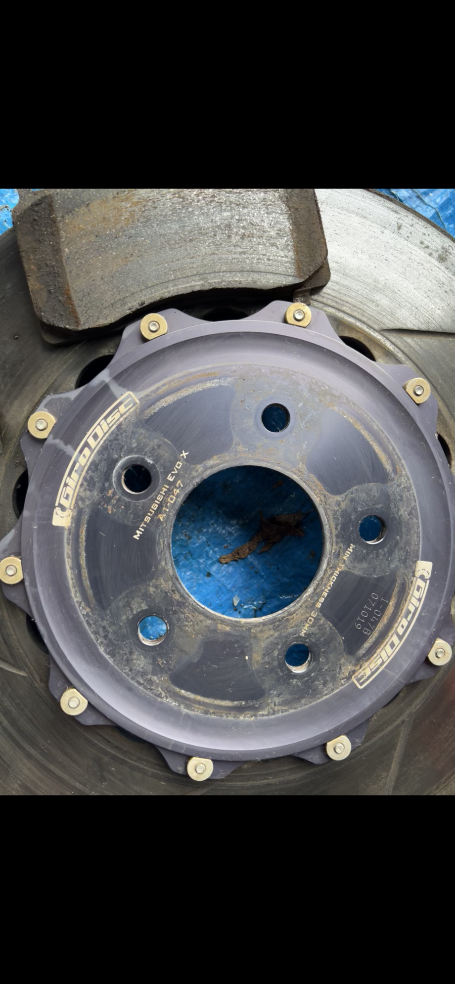

I think it might be the rotors ? PO had put griodisk replacements on , and Carvana probably put auto zone new pads on them, any stock photo install I see of the griodisk barely has a lip where the brake indicater rests and the hub meets the rotor . Also the car just threw p0138 code, and is have symptoms of a failed booster or booster check valve yet another issue. This car had to have seen frequent track days

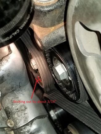

Hey just to add to this thread, if it still sounds like a belt type noise, check the belt tensioner itself, not that it’s bad. It could be but I have seen lots of evo x belt tensioner a installed where they are crooked! Not really sure what causes this other then a cross threaded bolt or just faulty install error but I have seen it numerous times. When it’s installed this way it still works but the pulley is not correctly inline with the belt line. It can cause belt or pulley noises. Maybe something to check. Post up if you get something figured out. Best of luck.
Borrowed this photo from another evo X thread to show what I’m talking about.

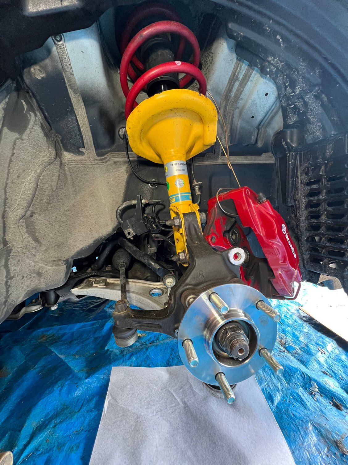

This ^ Carvana replaced the pads without resurfaced rotors , creating the griodisk pig squeal Record player. PO mush have ran smoked track pads before selling to Carvana
Decided to replace hub/bearing wile I was in there
