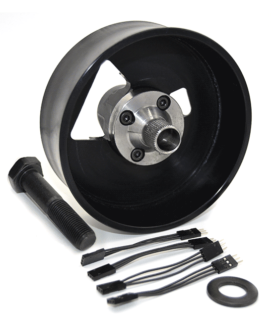

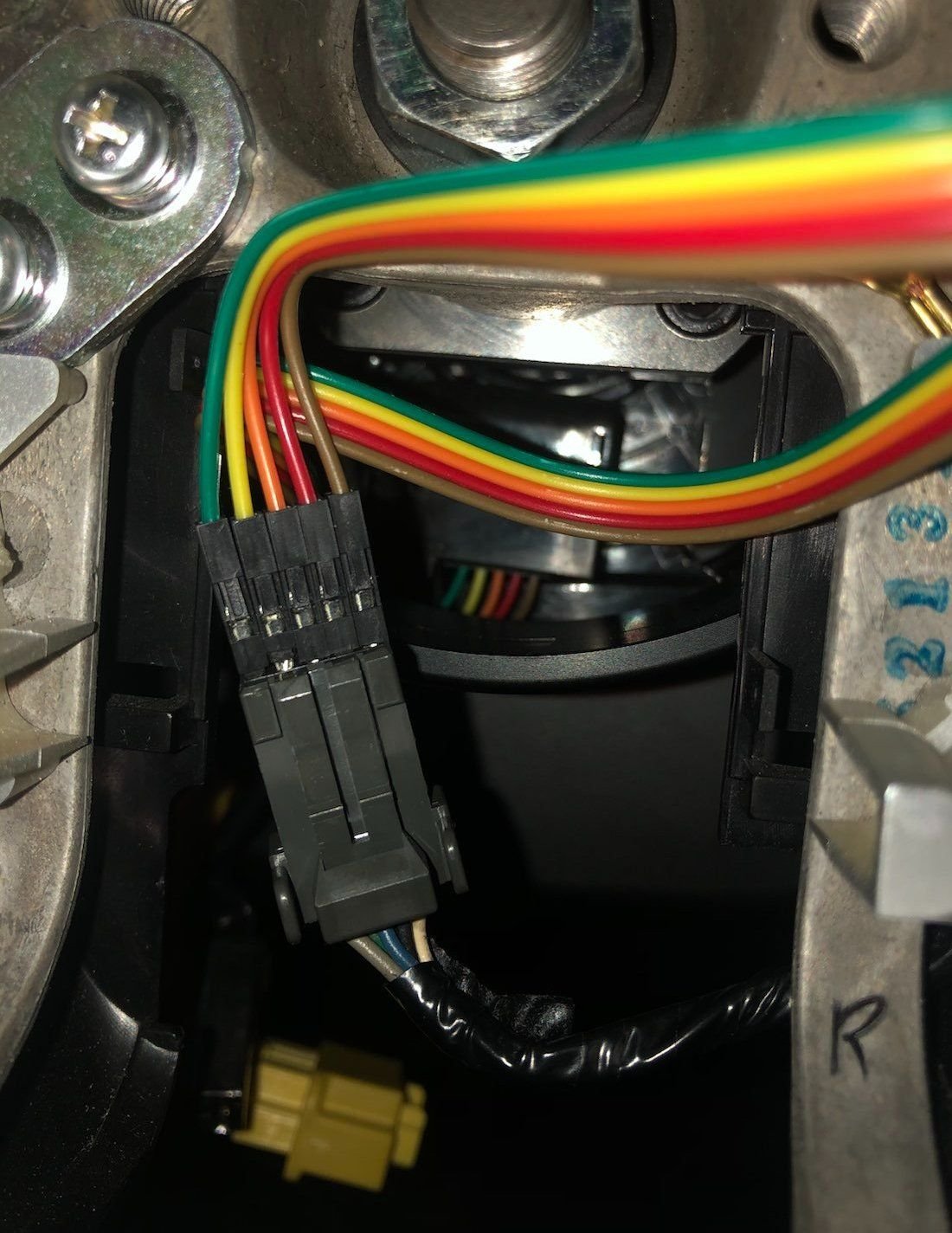

I wouldn't want to start splicing into wiring there. I might instead get some jumpers that they show on this image for the BMW:
It's kind of disappointing cause before buying, I did read their page that the wiring was long enough.
https://www.spacershop.com/prodotto/...-lancer-evo-x/
"The OEM wires inside the steering wheel are long enough to be easily reconnected without being under any stress."

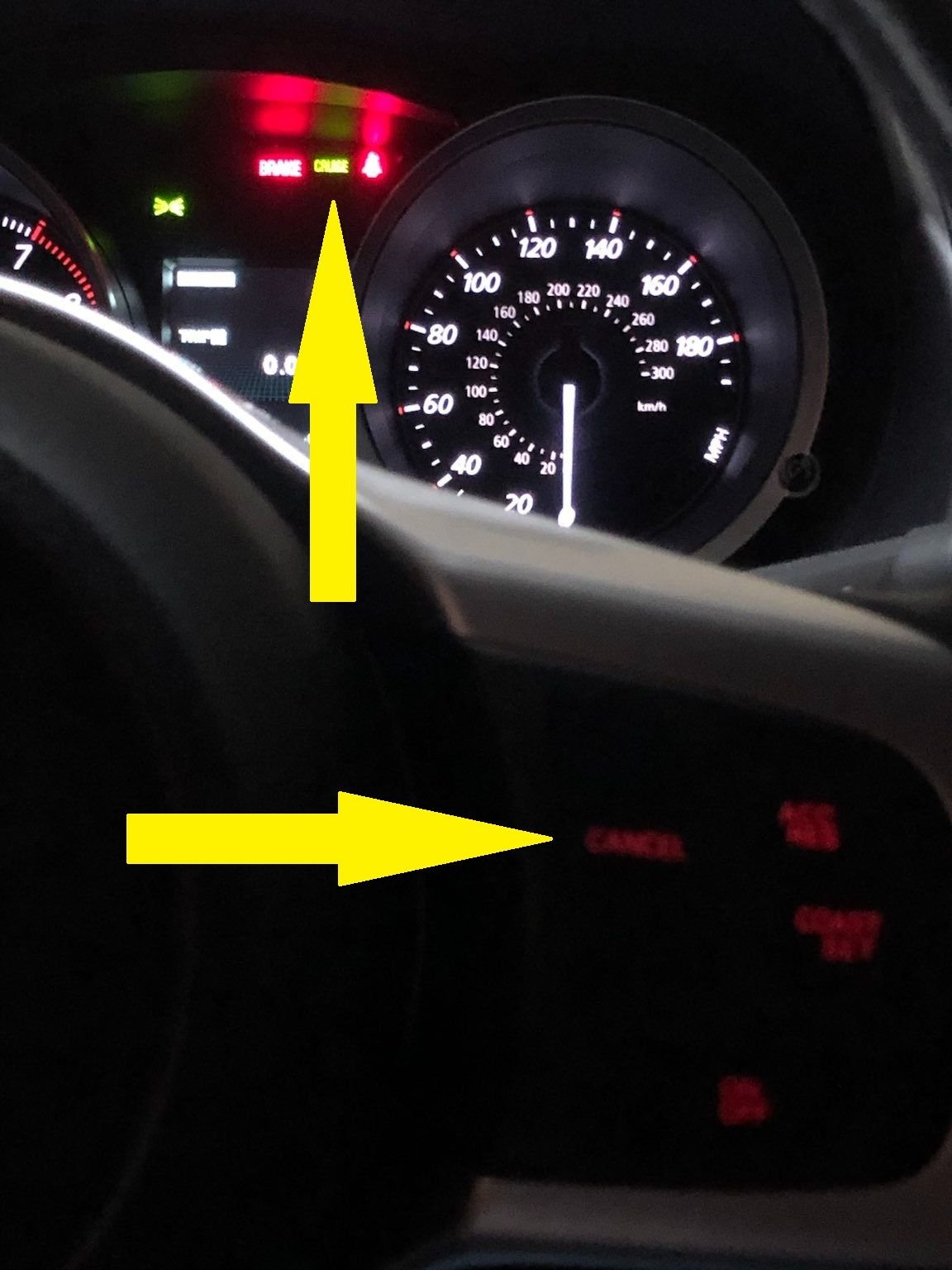

Got my wiring done. I might redo it in the future. I'll post the idea in the next comment.

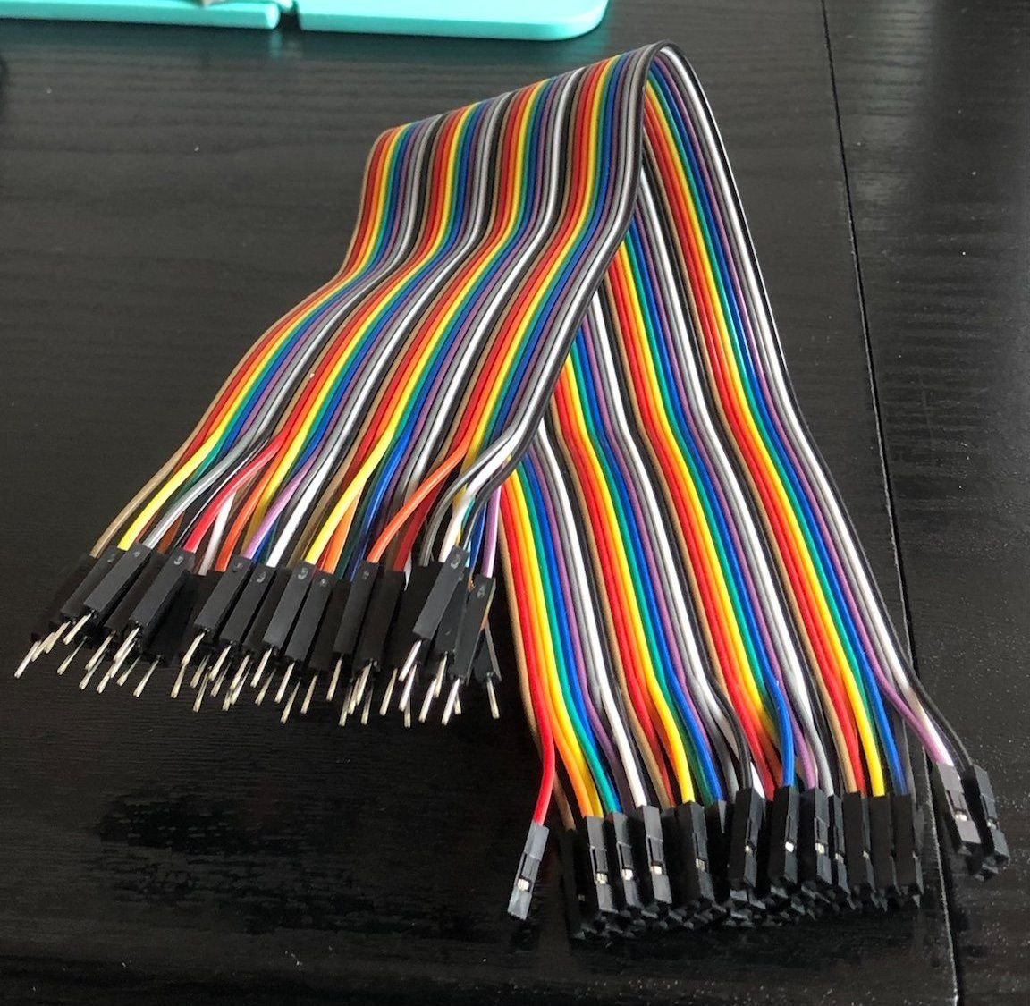

So I had some jumper cables around, used for wiring up electronics on breadboards.
They fit the OEM connectors pretty much perfectly as far as spacing. I did have to grind down the plastic for the male end above, just to expose more length of the wire.
I ripped off a string of 5 cables, this is nice because they're all kept together, no need for tape or zip ties, and it's easy to see their order:

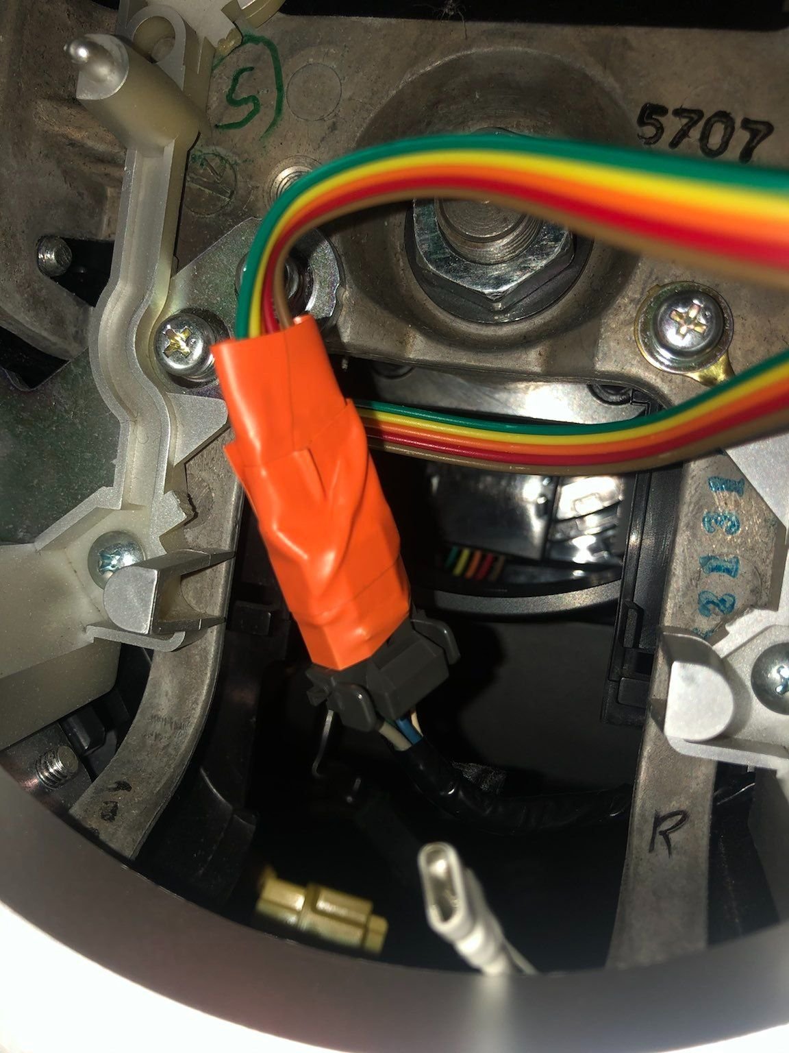

Then I just slipped them into the female OEM connector:
And the male one, on the underside of the clockspring. This was a pain in the butt though:
You can see how perfectly the female ends fit into the OEM connector, barely any gap between them, all in a perfect row.
With a ribbon like this, it's easy to keep the same order of wires, just match the colors up, like you see here:
Now, to secure these wires, since they don't clip in. You really can't do much about the clockspring side, almost impossible to get any electrical tape there, so you're just relying on friction. For the other end, you can wrap it all up in electrical tape, this should hold well.
I did secure the cable slack to the base of the spacer, as best I could, this should keep it from shifting at least.

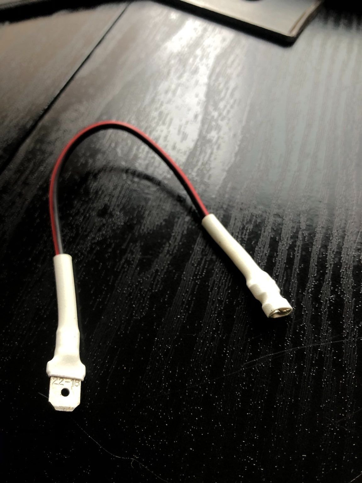

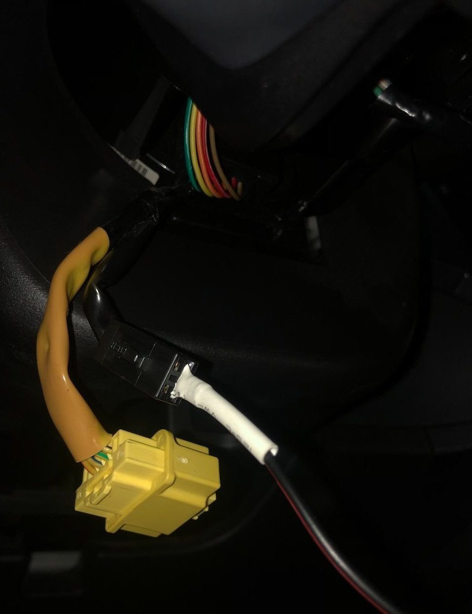

Now, we come to the horn. This is just a single ground wire, it appears to be standard size and I used-off the-shelf male and female spade connectors and made a short jumper wire.
Male end goes into the clockspring side (I did cut away some of the heatshrink just to get it in as deep as possible, is what she said):
Female end into the airbag.
And there you have it, fully working button lights, and you can see the cruise control light on:

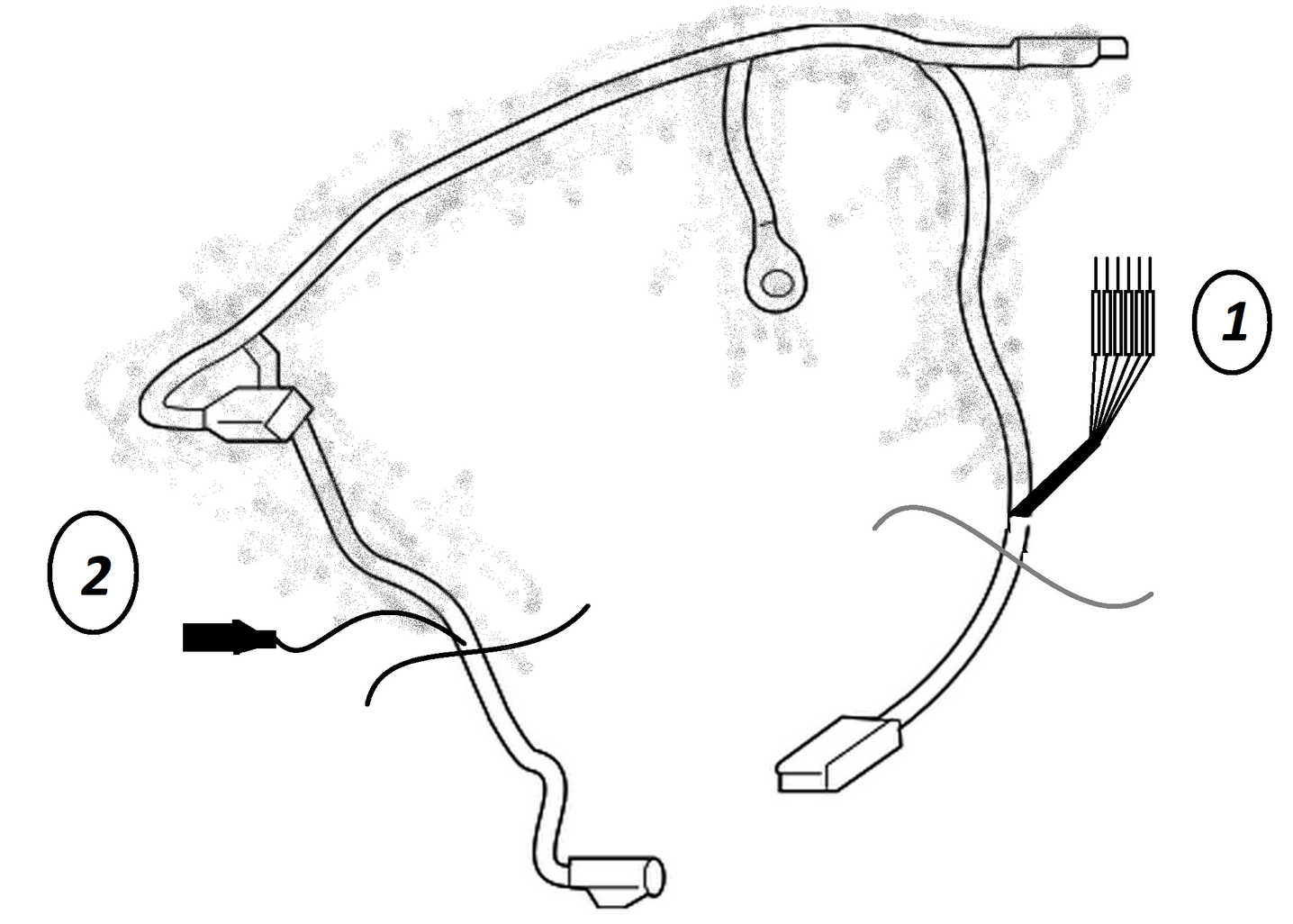

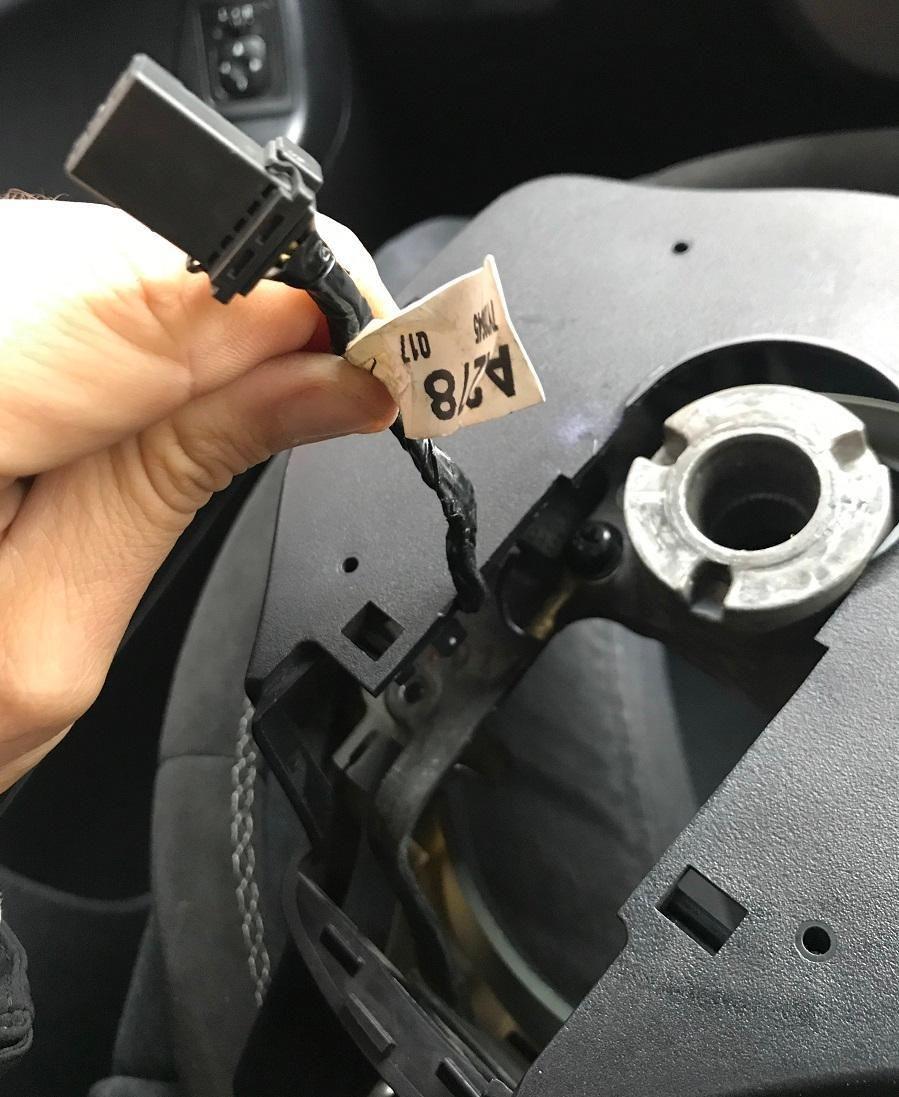

One issue with this is that the steering wheel controls wires are only held in by the friction of the OEM connector.
You can actually buy the OEM harness for the steering wheel, and it's only $20:
https://www.mitsubishiparts.com/oem-...ItMGwtbDQtZ2Fz
What I can then do is this:
My main issue are the male jumpers connecting to the bottom of the clockspring.
I could cut off the connector on the right and solder the male jumpers to that. So then the OEM connector clicks into the clockspring, and thejumpers at position (1) go into the existing connector on the wheel. And here, I can use electrical tape to secure them completely.
You can also cut away the connector on the left, solder on a spade so that the spade goes into the OEM connector coming off the clockspring, and the OEM connector in position (2) clicks into the airbag.
So you're improving the security of two connection points with this.

I did get a reply from Giacomo. You still need to make the spade jumper for the ground, but it looks like you could extend the other harness by pulling it out of the original position, so you could get it done without jumpers.

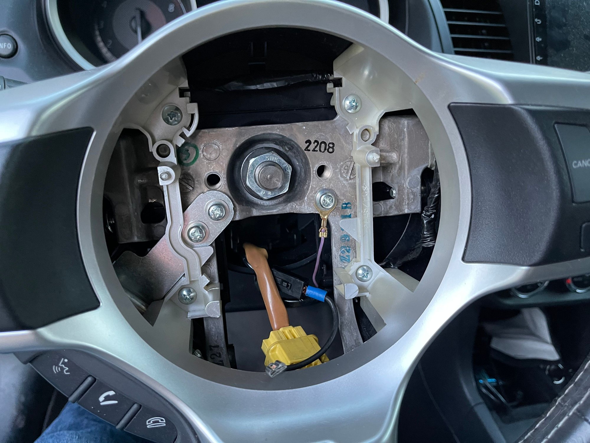

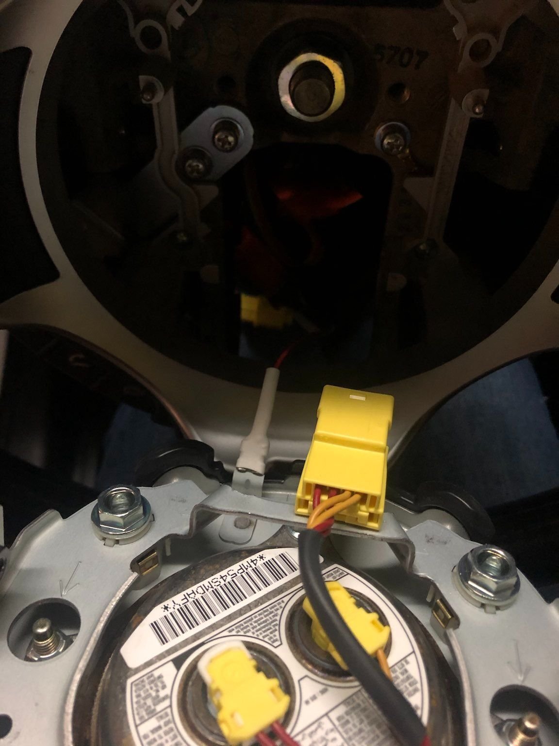

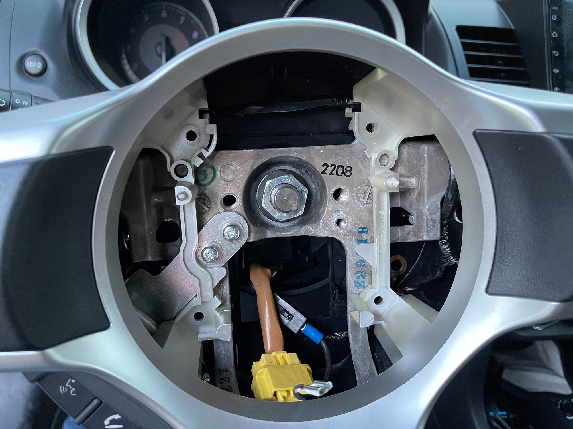

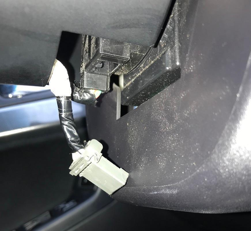

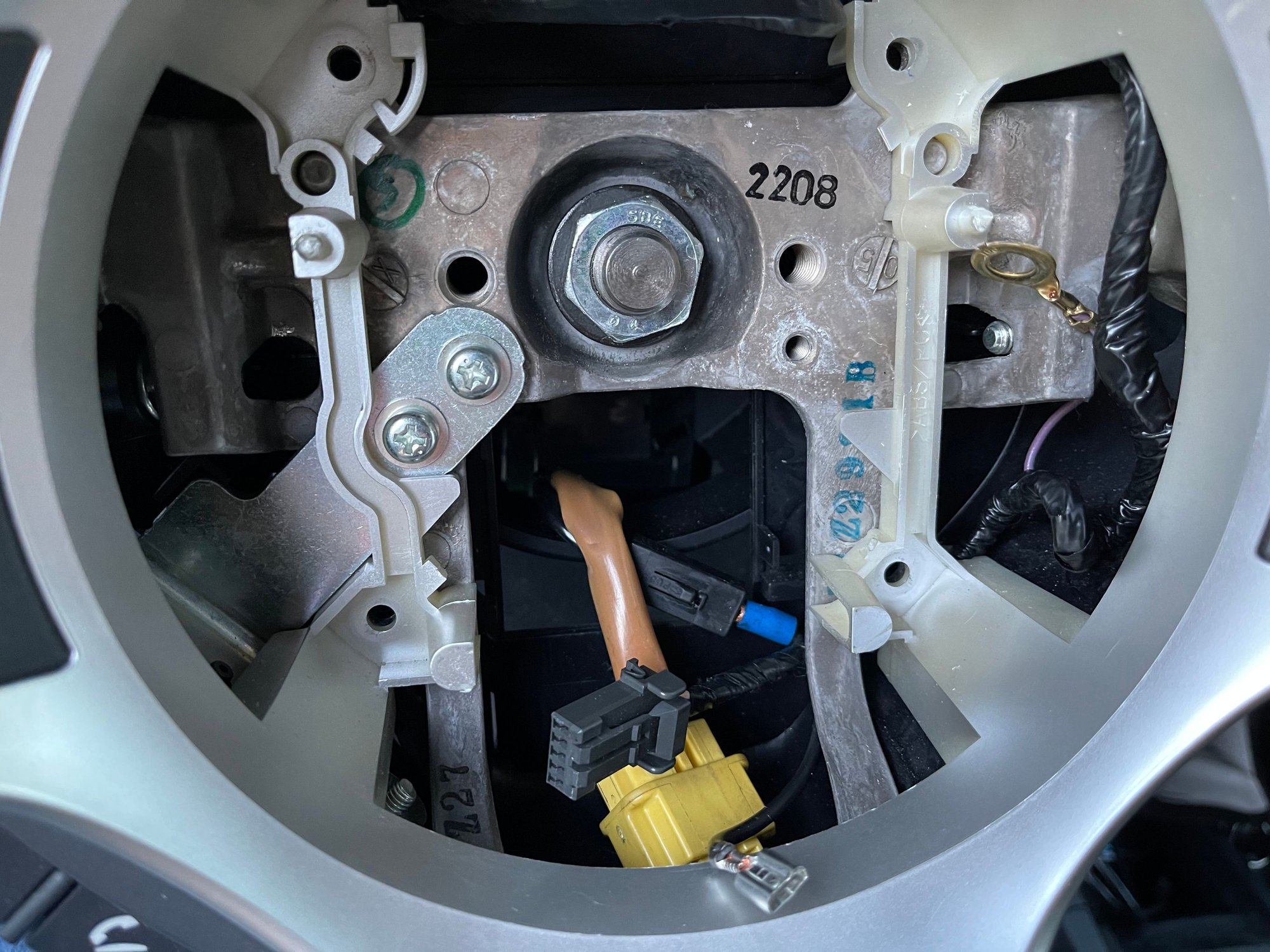

Originally Posted by 401evo
Did you end up installing it yet? How did you make out by relocating the harness in the wheel?
Yes it's not so much relocating the harness. If you can see in the first picture bottom middle there's a grey plug. That's the original position. The purple ground on the right, and at the top is the part of the harness that you need to extend. I've made some adjustments as you can see to essentially pull it downwards more to give it the necessary slack to connect to the bottom of the connector (5th picture). Last picture is the jumper for ground.
