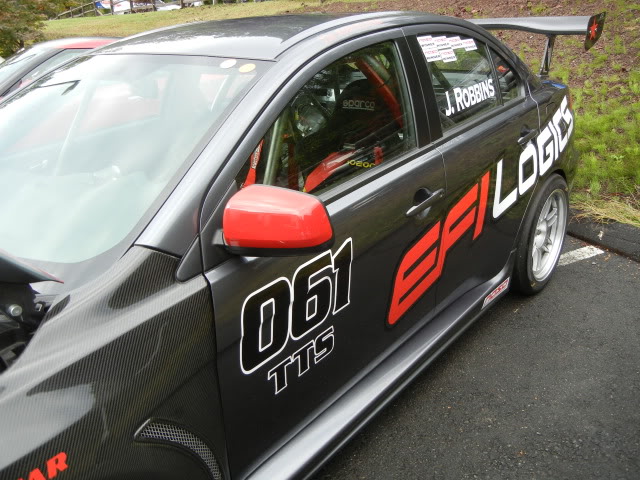

So, for comparison purposes, the race car is currently 3085 with five gallons of gas in the tank.
Gutted, of course. And there's probably another 80 lbs there somewhere:
Driveshaft
Heater
some metal tabs
Lexan for glass
I will say weight reduction gets expensive pretty fast.
Our problem became, as we pulled weight out we had to reduce power to meet class rules. Turning the boost down (along with timing and such) took the power out but killed torque faster. This required a different turbo to spool faster (was a FP Red now Blouch) and find us some lost torque. The faster spool introduced some throttle tip in overboost problems... it's a long road.
