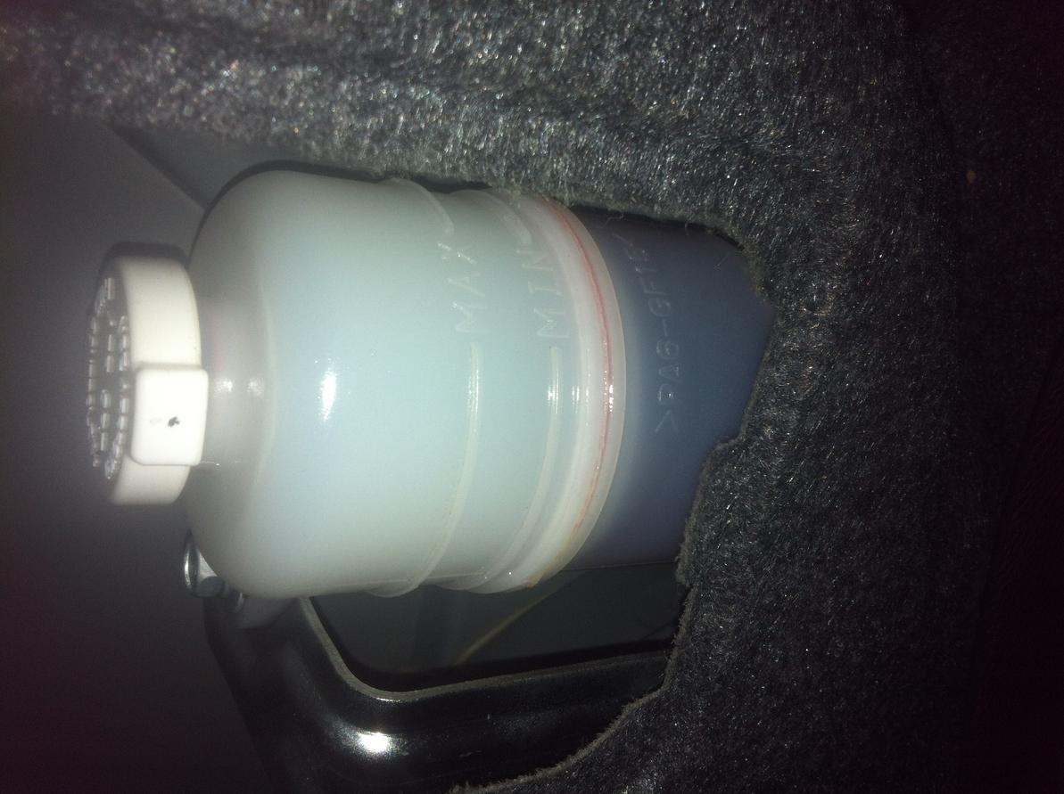

might as well post the pics of the fluid levels give you guys more info
the one that shows the bottle more full is before the diagnostic machine ran the pump system test, the pic that shows it more empty is during the test

I have no idea but I know the fluid in that resovior does gown like in the picture while the car is running a warm.. After a while it goes back up..
