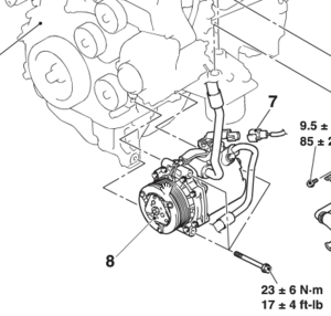

I have the same thing!
Low RPMs, whine.
I thought it was my steering pump, and after it got rebuilt for leakage it didn't go away.
I was under the car when it was on jacks, idling, and its defiantly the compressor...
I used my stethoscope. its definitely the compressor. I don't know why or how, but i feel better if it fails (and doesn't seize) it will not blow my motor.

Hmmm i'll check the compressor when i'm under my car this weekend.
Even if th ecompressor does sieze, it won't break the engine.... It'll just break the belt. I had that happen on my 240sx. No AC and power steering is fun in texas in july

Haha I can imagine. Let me know what you find, it annoys the heck out of me, but I don't really want to swap it out.
Also, I was reading it had some sort of clutch assembly, maybe something is rubbing. Not sure...

An AC compressor uses a electromagnetic clutch assembly. That's how it "turns on" the actual compressor component, it electrifies a coil surrounding the driving shaft to pull the pulley into contact with the shaft which therefore spins the compressor. If the clutch assembly is bad then I could see it causing a noise, but there's an infinite amount of variables to an engine compartment noise. Could be a ton of things..
