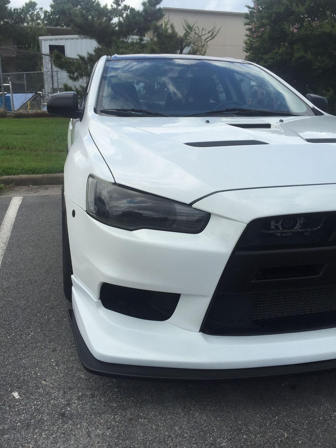

yes the quick release would work.. my bumper literally had no tabs to hold on anymore.. this is mine after installing the quick release
.. if you went for the quick release route you need to be accurate on where to drill holes and if you mess it up theres no going back.

mine cost $115 and move over cost $205 but its well worth it.. when i scrape on my bumper my quick release tab doesnt come off
