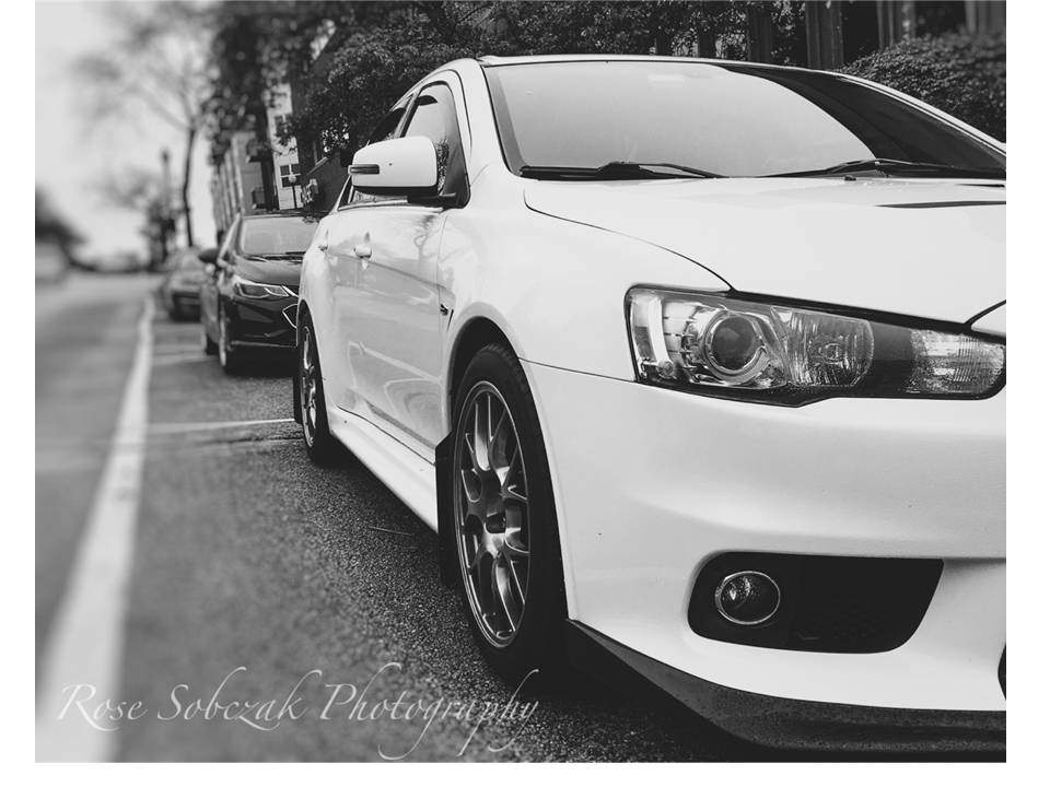

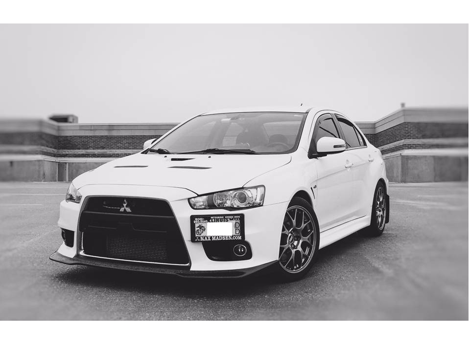

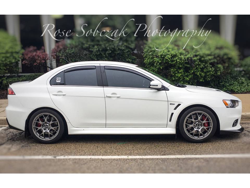

What size rubber are you running? That will determine your wiggle room with spacer size.. if you are still running 245s then i would just go with a hubcentric, extended stud 15-20mm spacer for sure! you will be pissed that you went with a 10mm I promise you...
I'm dropped 1.25F and 1.0R with a 20mm H&R Traks and have ZERO fender rub/scraping.... I can take better pictures and post them tomorrow but here are a few for now (these were taken 24hr after i put the spec R springs on the car and they have settled alot more than what you see here
