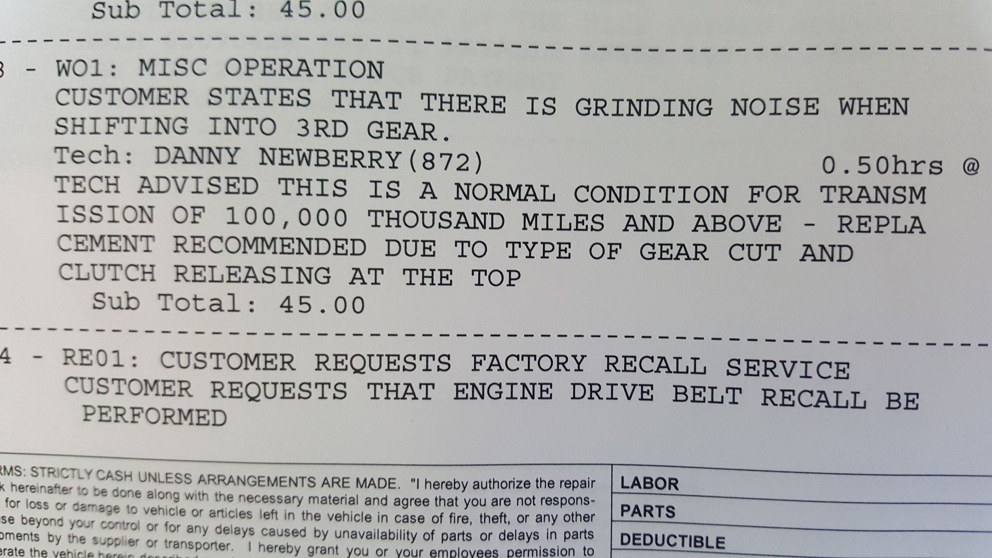

So I had my car at the dealership for a recall and to diagnose a few issues I'm having. One being grinding into 3rd gear occasionally. Well, they are trying to blame the clutch for it, which is a fairly new clutch. I have no slipping issues or anything with the clutch. They pointed out that it releases at the top, but it's nothing I've noticed. I don't see how a 'bad clutch would cause only one gear to grind. The main reason I am posting this is because of the nonsense they tried to tell me...
According to their tech, the Evo is basically a race car and needs it transmission replaced at 100,000 miles because of the 'gear cut'. I called a second dealership that has 'certified' Evo techs and they said that was ridiculous. Bad part is, that dealership is roughly 3 hours away.

The grind is due to a failing syncro. An improperly adjusted clutch could be to blame for this but its also a wear item so slamming gears and miles takes a toll on them.
But while I mention that a clutch not properly adjusted could cause this, the fact that your clutch engages high is actually to your advantage here. Its the reverse which tends to kill the syncros as a low engagement point means the clutch may not be fully releasing thus potentially locking you out and causing premature wear.
At the end of the day I'd go to a different dealership bc they are clearly full of it. Good luck!

When I got the car back yesterday, I noticed that the mileage had not gone up more than a mile, doubt they even gave it a thorough test drive.

Look on the bright side - it only cost you $45 to find out that dealership is useless... Some people have to spend >$1K to find that out!

I don't know what you have done to the car, so if you have already done the following then disregard:
When I first test drove my X it had just over 52k miles and I noticed 3rd gear was notchy and kinda grinding a bit as well.
As soon as I was able to get home I ordered every bushing you can get from the shift selector to the gear lever itself without replacing the entire shifter box. It was just over $100 in bushings and it cleared up my 3rd gear problem as if it never existed.
Fast forward to today and currently at 112k miles, still no grinding or issues. Also, it might help to that I use the RedLine cocktail trans fluid mix.
