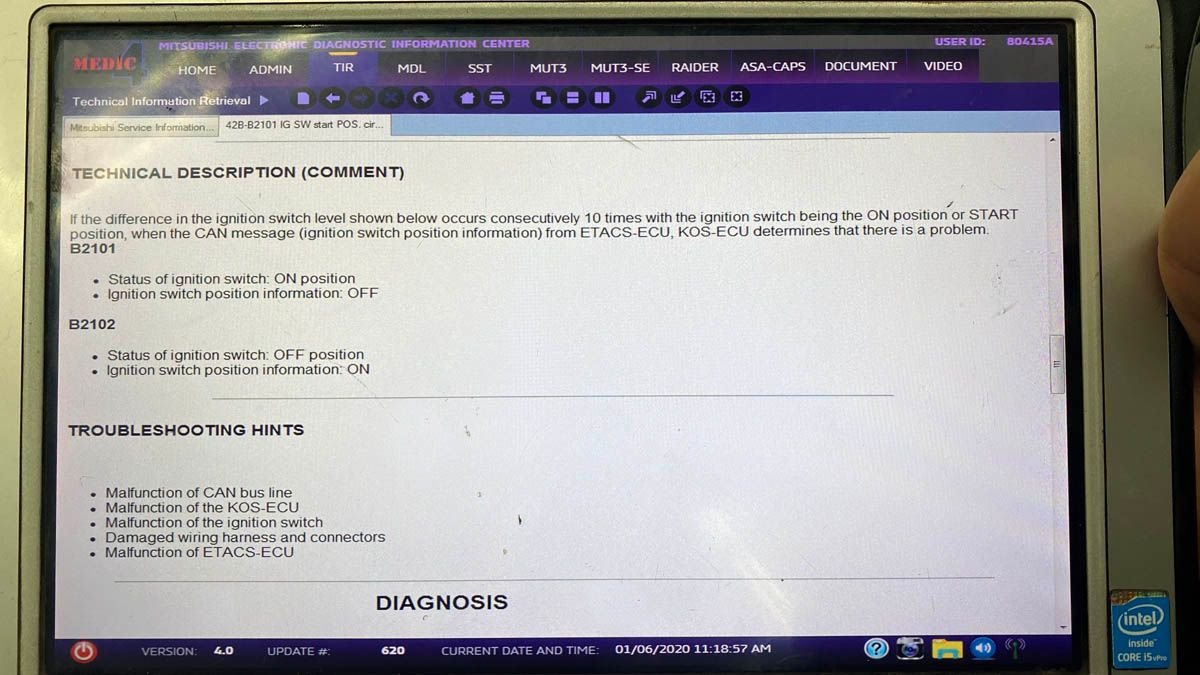

Recently my dealership noticed the B2102 diagnostic trouble code (DTC) has been stored in my Evo X during a service visit. This happened previously, but they were unable to find out the cause.
Long story short, we brought in the master tech and he did a few tests. It turned out that this relates to the (aftermarket) remote starter. As a manual car, if I turn off the engine without stepping on the brake, the remote starter will keep the engine running and stop the engine only after I have closed the doors and locked the car. In that way, the remote starter knows that the shifter is left in neutral for remote starting.
Evo X's (factory) ECU will register an event whenever the ignition switch (knob) is turned off, but the actual ignition is still on (i.e. engine still running). If this event happens 10 times, it will store a B2102 code.
So the bottom line is that there is nothing to worry about if you have a similar remote starter that keeps the engine running after you turn off the ignition switch (knob).

In case if anyone cannot see the MEDIC screenshot above:
Mitsubishi Electronic Diagnostic Information Center
42B-B2101 IG SW start POS cir
Technical description (comment)
If the difference in the ignition switch level shown below occurs consecutively 10 times with the ignition switch being the ON position or START position, when the CAN message (ignition switch position information) from ETACS-ECU, KOS-ECU determines that there is a problem.
B2101
* Status of ignition switch: ON position
* Ignition switch position information: OFF
B2102
* Status of ignition switch: OFF position
* Ignition switch position information: ON
Troubleshooting hints
* Malfunction of CAN bus line
* Malfunction of the KOS-ECU
* Malfunction of the ignition switch
* Damaged wiring harness and connectors
* Malfunction of ETACS-ECU
Version: 4.0 Update #: 620
The shortcoming with the MEDIC hints is that it does not take into consideration that many Evo X's have remote starters. If an inexperienced technician relies on the MEDIC tool only, he or she will end up running circles diagnosing CAN bus line, the switch, and the ECU's without realizing the stored B2102 code is normal with the remote starter.
