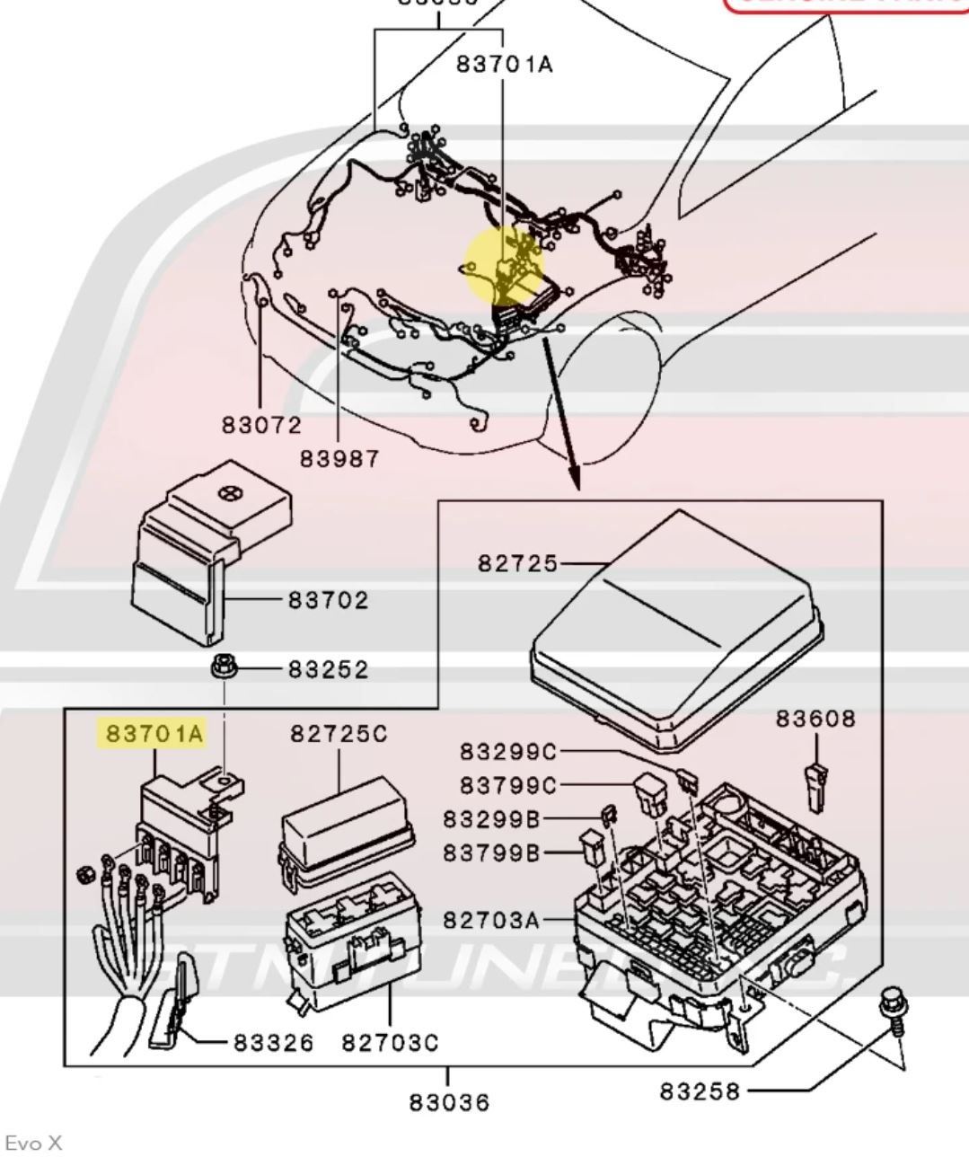

There are 4 fusable links under the red jump terminal cover in the engine bay. If those are good, it's time to get a volt meter out!

There are the fusible links that I posed earlier and a handful of big fuses (40a-30a) in the under-hood fuse box on the left edge that feed other systems.
