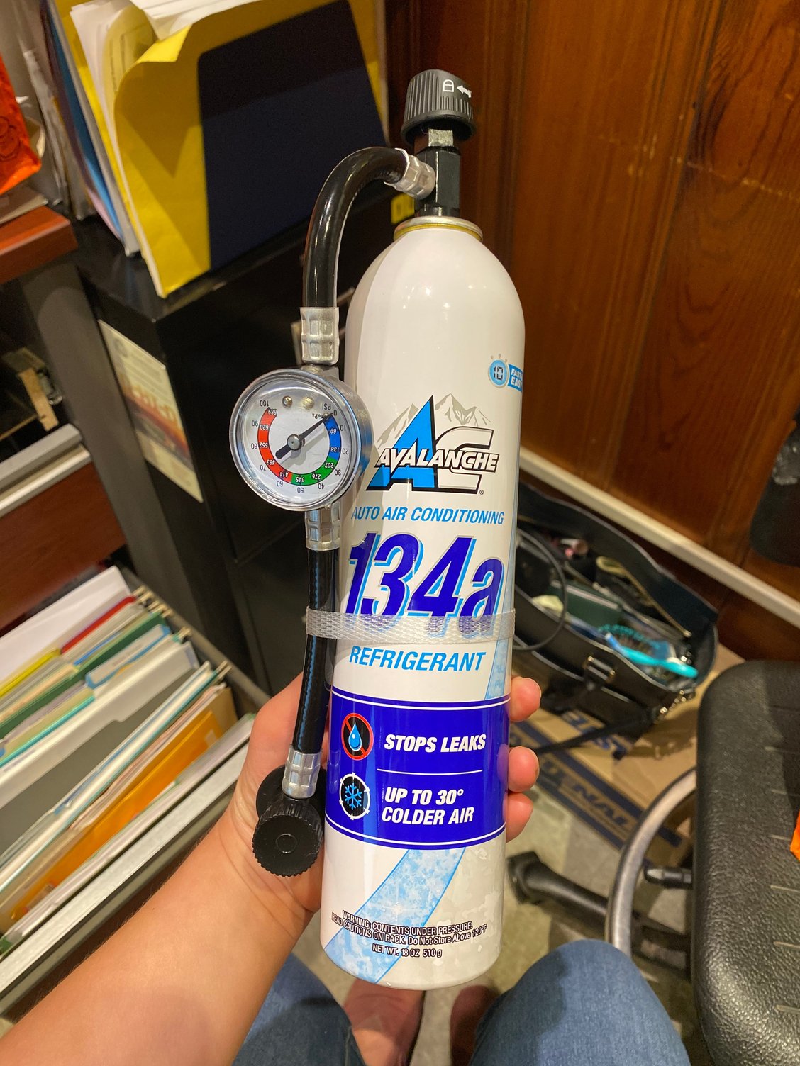

Mira fully intact, everything is still on the car as I haven’t taken it apart. The blower fan is still fine as well. This is what I picked up from AutoZone

Does that recharge kit have dye? I've never had success with stop-leak on AC. It might work for a couple months with a small leak but if you blew out a seal or an o-ring it might not even hold the charge.
If you want to try out the parts store kit, go for it. If it fails again / doesn't stop the leak you need to take it to an AC shop to fix the leak, pull a vacuum, and put the right amount of oil and refrigerant in.

thank you! I’m sure that will probably be the way to go as any job done is never the easy way or the cheapest. I’m gonna put the recharge in and see what happens. Hope it creates enough pressure to engage the compressor. Big fingers crossed! I’ll let y’all know here soon!
