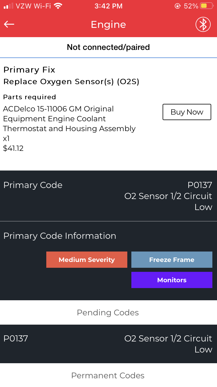

I'm not sure which o2 sensor it is, I've attached what my OBD reader app says, am I able to know from what it says there? It's stock engine wise, just on wheels and lowered. I have a multimeter coming in the mail tomorrow so I can start testing the sensors and wiring and such.

P0137 is the Rear O2. You can try a fresh sensor if you're on the stock catalytic converter. Also, I love that your app is suggesting you buy a GM Thermostat housing to fix this!
There should also be codes for the AWC ECU if it's throwing the service message, but your app won't be able to read them. Evoscan can get you more information if you have a Tactrix cable otherwise you'll need a higher-end CANBUS scanner or a trip to the dealership.
Thanks for the feedback, I really appreciate it. I'm taking it to a shop up here next week where I'm guessing they'll just end up replacing the sensor, which hopefully fixes the CEL code. As far as the AWC problem, I'm unfamiliar with Evoscan. When I go to the website it's a bit confusing. Are they for tuning? Or if not what is their main purpose? And how would having one of these help me with the AWC issue?
