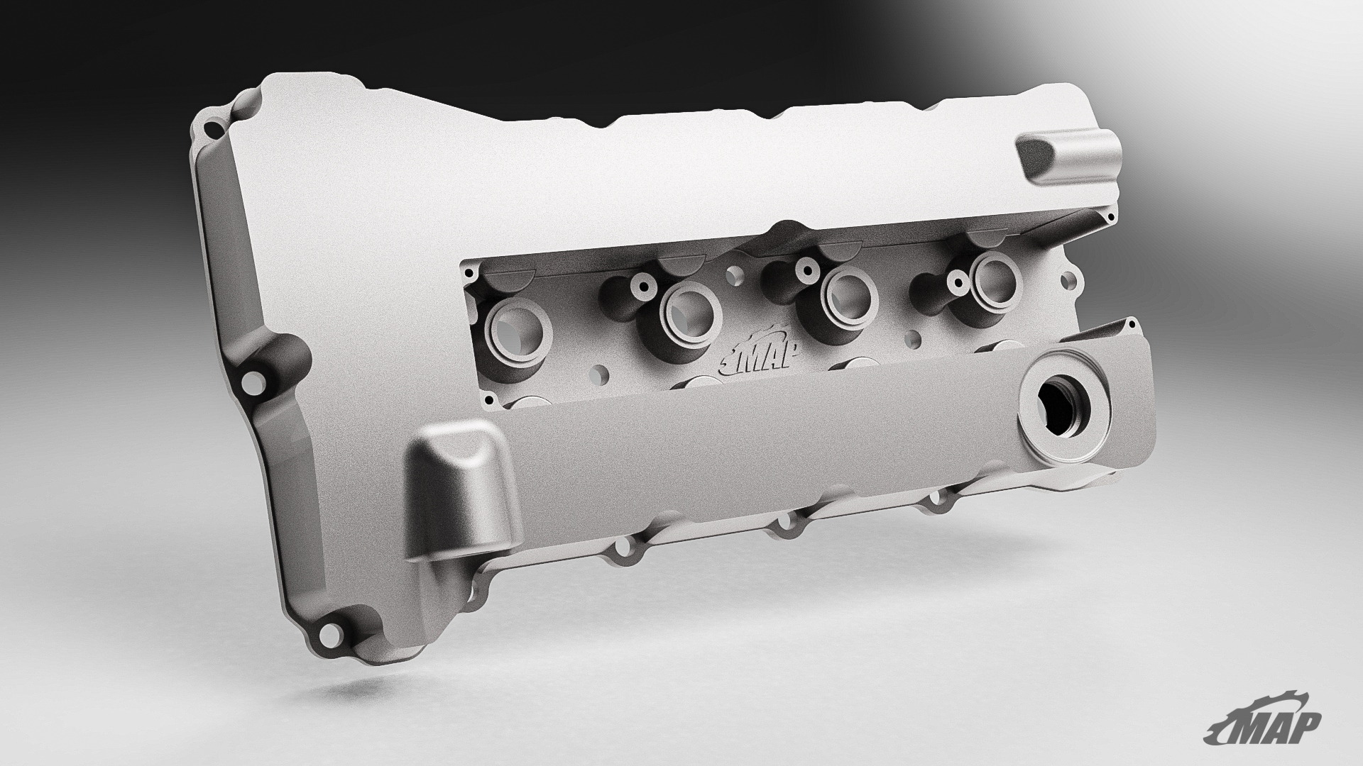

We're excited to share with you guys a few renderings of our MAPerformance Evo X Cast Valve Cover that we've had in development for awhile now!
After seeing how difficult it's been to source the OEM valve covers we decided to create our own so you guys won't have to wait through the crazy backorders.
Of course, we couldn't just replace the factory component so we added a couple of additional features:
- 10AN ORB fittings cast in with included barb fitting for the stock PCV system

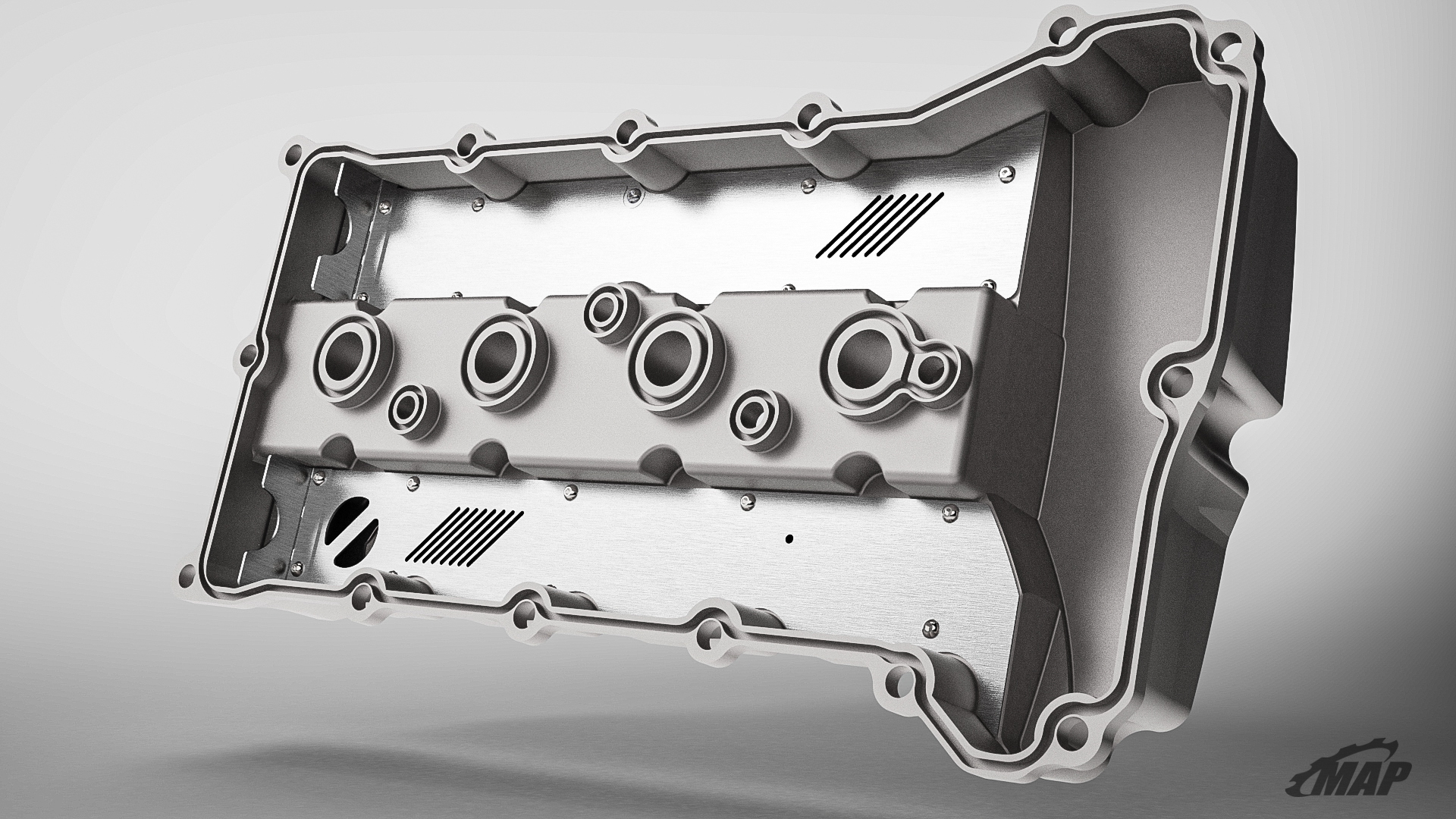

- Removable oil baffles
- OEM gasket set included
Additional options we're looking at:
- R35 coil pack upgrade
- Flush-mount spark-plug covers
Pricing is looking to be right around $500.00 but we'd love to hear what your guys think and any feedback you might have!

do the baffle plates have something that promotes oil drainage?

The baffles are designed to have more cross-sectional area for air to pass through into a catch can - with the goal of reducing crankcase pressure on highly modified engines flowing a lot of air. Ultimately though, they offer the same hole locations as the OEM valve cover, however, our testing showed no issues and did not pool excess oil on top of them.
