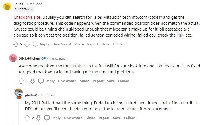

Maybe your "trustworthy" mechanic didn't reset the ECU's learned values after replacing the timing chain. Typically this is done by the Mitsubishi dealer. Some very Evo-savvy shops might be able to do this too. Stick-Kitchen has a Reddit thread discussing this:
The mentioned Mitsubishi Tech Info's diagnostic procedure is as follows. I would follow this procedure and first suspect the oil control valve if the P0017 comes on out of nowhere. However, I would first reset the ECU's learned values of the exhaust valve close timing if the P0017 comes on right after a DIY-replacement of the timing chain:
Good luck resolving this issue on your Evo!
he did use a obd machine (not mut3) to reset the value. Maybe it must be using a mut3 device?

I'm uncertain, but very possibly. Dealers do use the Mitsubishi MUT3 tool for the reset. acm_evo talked about this in the past:
Originally Posted by acm_evo
If you know someone with access to Mitsubishi MUTIII tool, then you can run the procedure to re-learn the timing chain learned value. Without that, I'm afraid you're stuck having to go to the dealer. That light will come back on after less than 100 miles each time you reset it.
