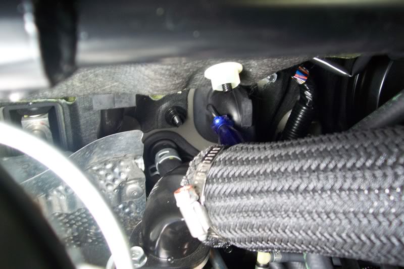

2 - Now poke a hole through the grommet on the left side just above the little tab that appears to split it in half. Go nice and slow, while turning the screwdriver, so that you don't snag any wires and don't cut into anything.

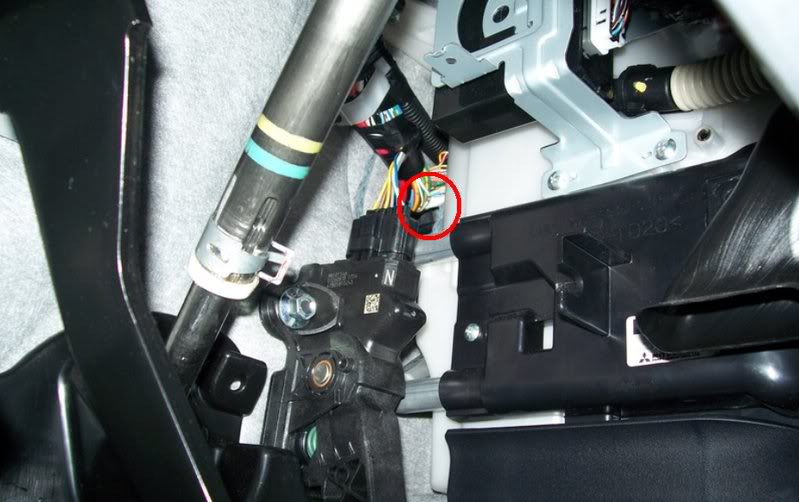

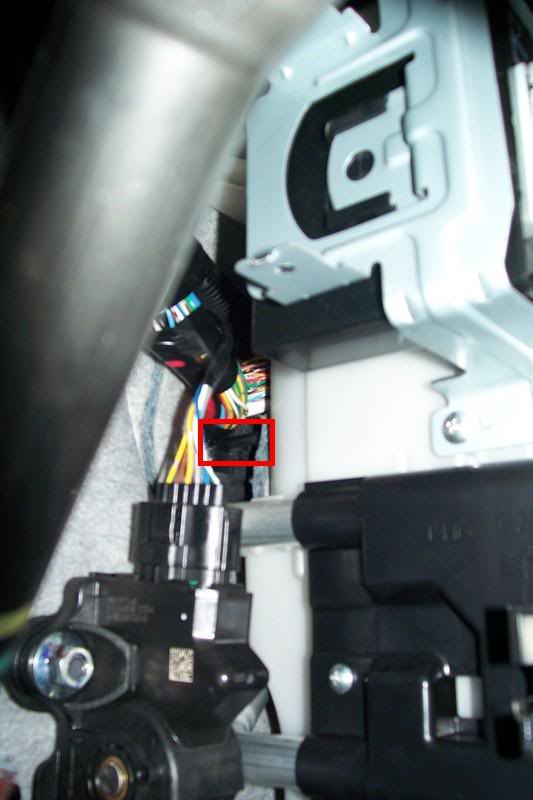

Firewall - Cabin Side - It completely misses the wires, since the wires come in and cut to the left, and we made a hole on the right, there is actually enough room to pass a vaccum line or sensor wires or what have you.
It may be hard to see, but there is a Thick White Wire in that harness. I have the screwdriver coming out well below it. Its silver, so look again and you will see it.
If you need it bigger, you can cut a bigger hole with a razor or if you want just cut the tape off from the wires and try to slide it down. I went with the easier approach. Just keep in mind that there are very fragile, thin, important wires there. Don't go to fast, and use a phillips.
