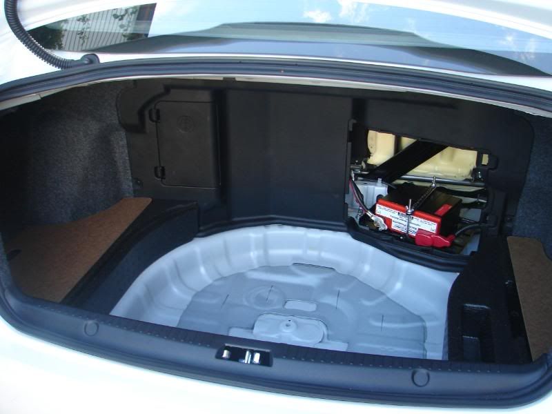

So yes, our babies are a little fat but here's my first idea in lightning her up. Enjoy

It will only last a week or two depending on your weather and options (alarm). I have been through 2 of these already. The AMS provided battery only lasted me 9 months and would only hold a charge for 3-4 days. I got the Odyssey red battery and all is fine so far, it will still only last about 10-15 days sitting in my garage, so I keep a Battery Tender on it now.

Finally found the photos, I added a Battery Tender connection to my small battery kit and I plug it in when I anticipate not driving the car. Very simple and cheap solution. The problem with the small batteries is they usually only have ~500 or so deep discharges in their life. So letting the drain fully, which happens quickly, will reduce the lifespan of the battery.
