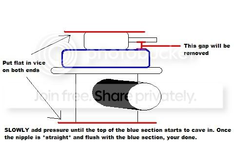

I don't recommend VTA. But this is the $1000000 question. What's wrong with the stock bov? Unless you're pushing some mad amount of boost (27+ psi), there isn't a reason to ditch it. You can even crush it and make it hold even more.

^what is this crush you speak of? i like orange crush.

Crushing the bov helps hold more boost...
A decent diagram. Don't use wrenches like others. Do it with precision. I also don't recommend doing this without a tune and somebody that knows what they're doing.
https://www.evolutionm.net/forums/ev...sh-ix-bov.html
