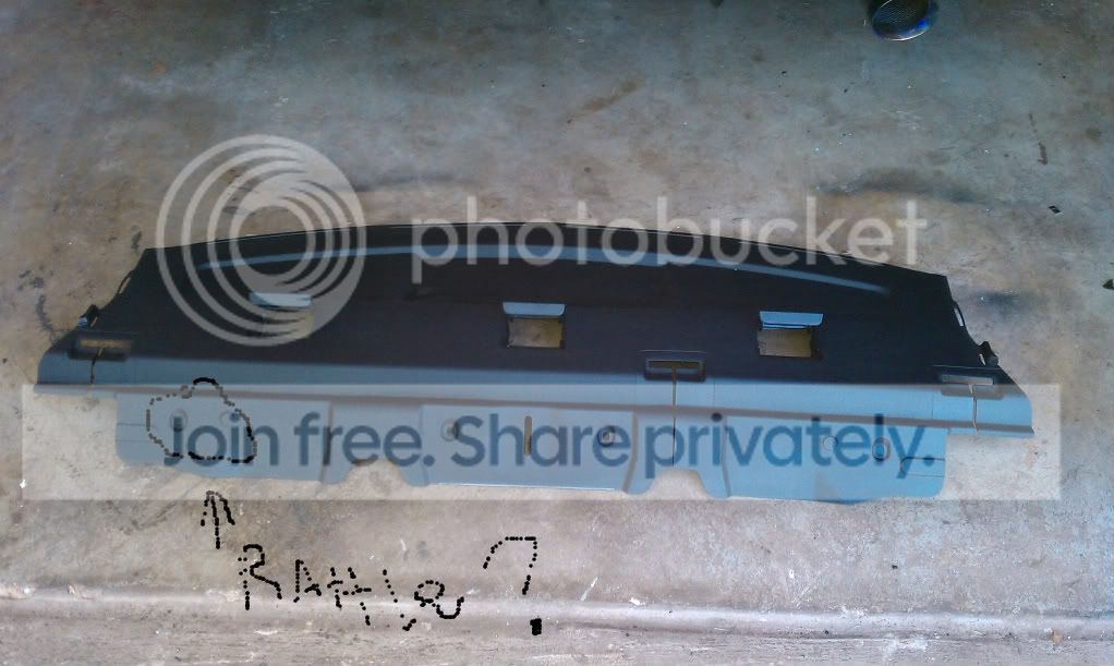

So Is there a DIY on getting to, and removing this rear deck panel? It's apparent the rear seat comes off. I have a BIG problem with the low Bass (from the subwoofer, and things rattling back there. Any help or links would be much appreciated!!!
Originally Posted by lancer0220
$15 bucks and a few hours of time.
Also I found that the majority of the rear rattle comes from the passenger side part, its actually the small portion that hangs down located behind the rear seat. SEE PICTURE BELOW.
After carpeting the rear deck i used dynamat on the small portion that hangs down. i just had some left over from an installation i did a while back, i took small strips and put them where i noted the rattle would come from (simply hit the rear deck and listen for the rattle).
the picture below shows where my rattle came from.
Have had 0 problems since, previously i had a pair of pants laying on the rear deck (dont ask i think i meant ot take them to the cleaners but forgot) and a shirt wedged in between the rear deck and the rear window to eliminate the rattle.
edit.
Thats where my rattle was coming from especially with an aftermarket exhaust.
