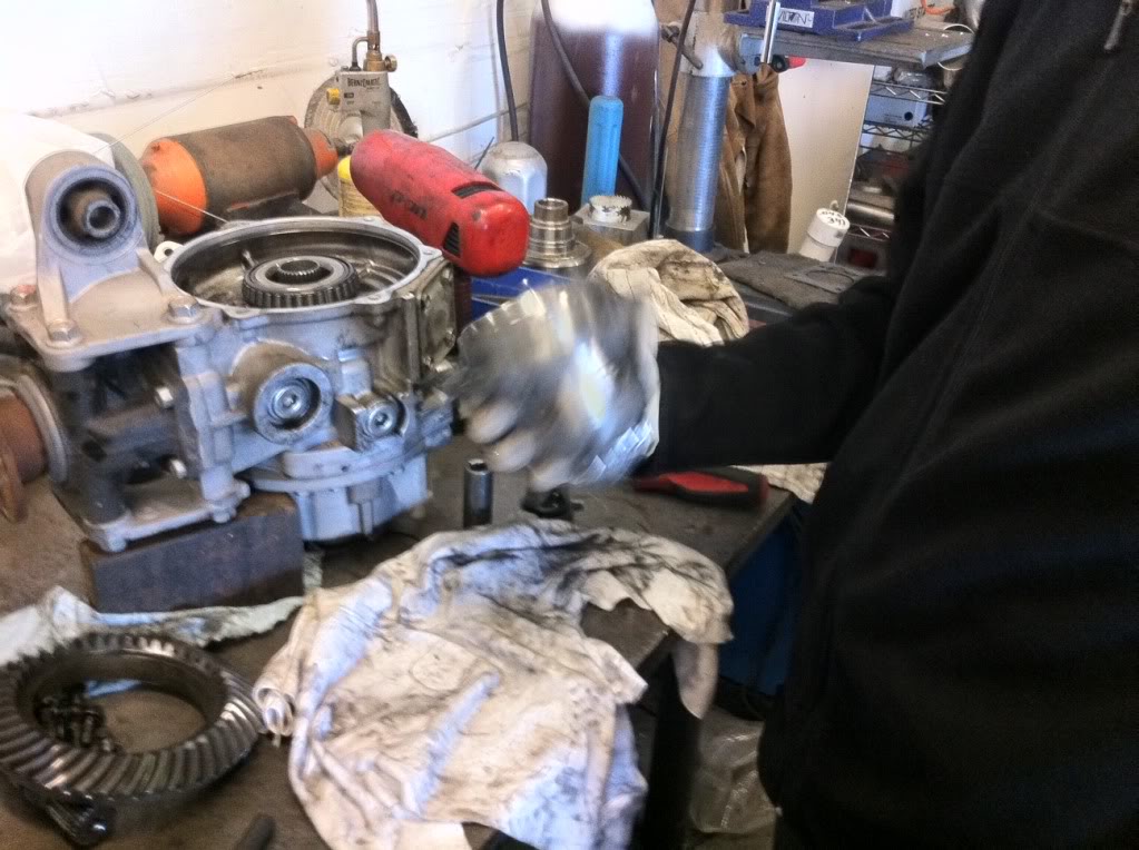

So thanks to Mert at GST, I got my Cusco RS 1.5way rear diff installed.
Attachment 315151

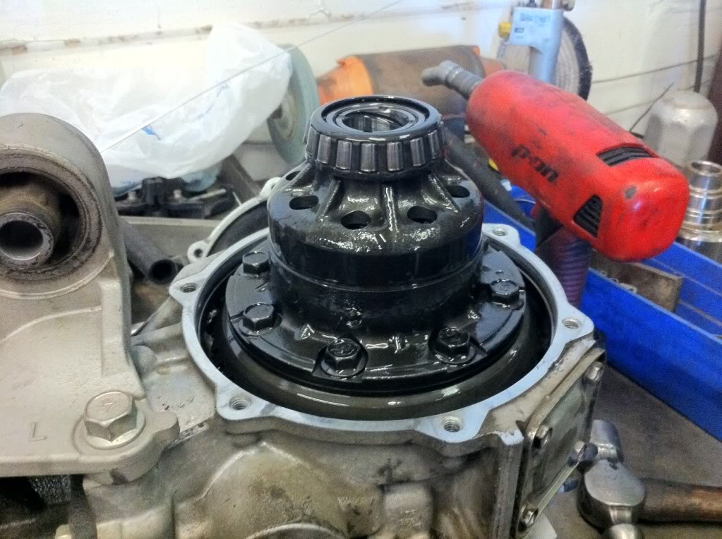

So like any diff install, you gotta get those half-shafts and drive shaft out of the way first. Disconnect the AYC lines, 3 bolts, and the diff comes right out. After that, you unbolt the side of the pumpkin that houses the rear diff.
Attachment 315152
Then you just slide the old diff off, unbolt the main gear around it, and transfer that gear to your cusco diff.
Attachment 315153
You can attempt to transfer the old side bearings too (the ring of bearings on the top of pic 2), but that's definitely not something for the timid. It's better and safer just to buy new ones.
After that, you just bolt everything back together and put the housing back in place. Put new SVG fluid in the diff part, ATF SPIII in the AYC part, and then bleed the lines. Thankfully, I was able to use the new application from Tephra to do that part.
