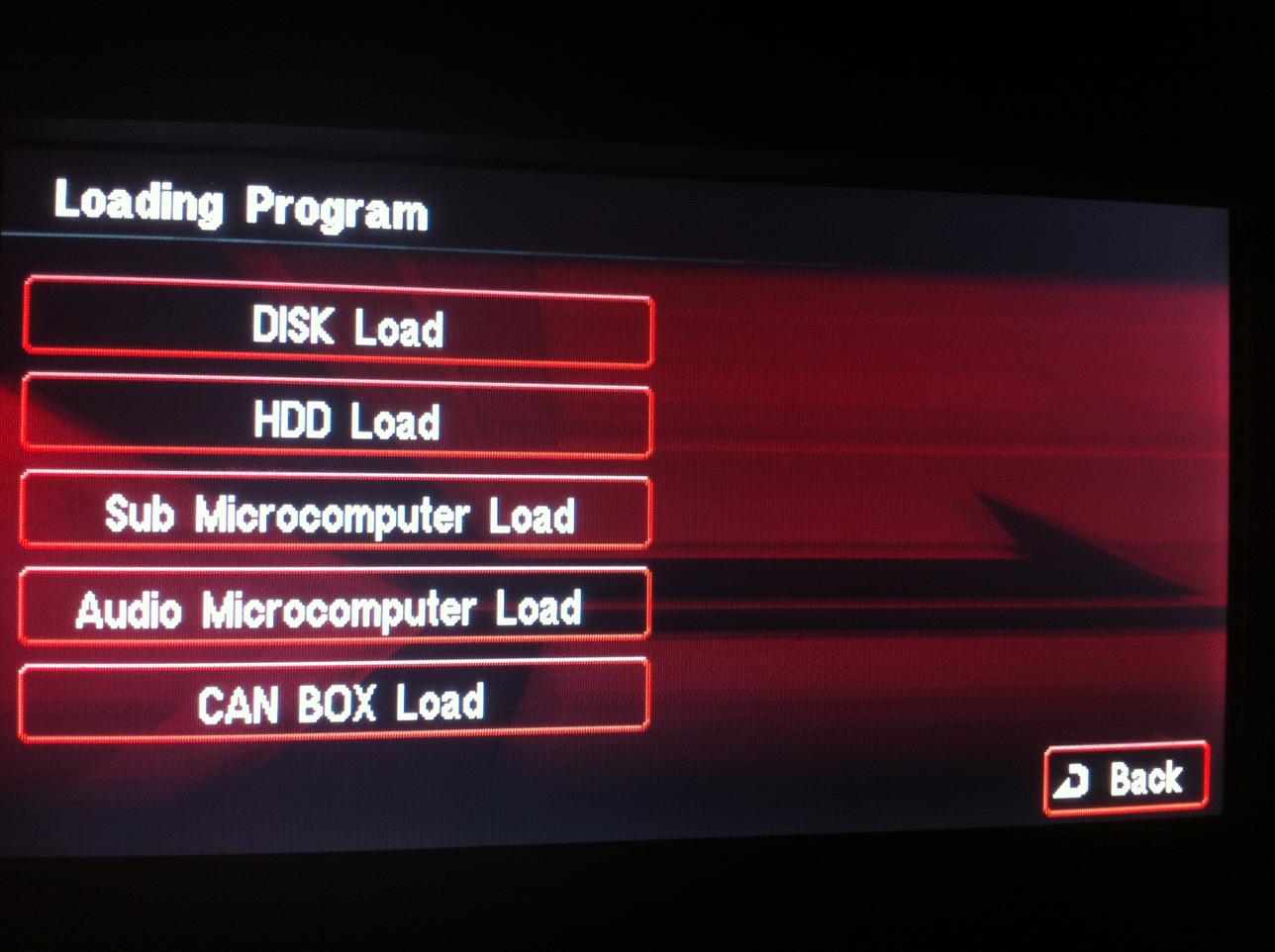

Hi, all just a quick update I finally find out why my Bluetooth not working and cause Navi to get "cannot display because of system error" I updated my US MMCS (NR261UM) to NR261EM version……….everything work fine just Bluetooth don’t work……….. anyone out there did what I did and solve the problem…. I would really appreciate any kind of help

You realize EM is European market not us market right...?

Yes and by the time I realize it's to late..............I can't even downgrade

try the correct one? what happens? 70.04

that's why Bluetooth is not working mine Navi was UM 30.97 and updated to EM 40.01 few years back and this year back to UM 70.04 and when I updated to 70.04 my Bluetooth icon on map dissappear...........my phone is still there (meaning I can still delete from system) just can't use it

Anyway thanks for the help I'm still taking it in to dealer and see if they can reverse it and fix the system error I'm getting
If you're having troubles downgrading Chi Chi, I'd recommend trying the following, as long at your have the correct version downloaded to a CD:
"The main issue with that is that unless you upgrade from a REALLY old version (MMCS won't auto update via CDROM to an older version) you can't do it without taking out your drive and doing all this dorking hacking magic....UNTIL NOW!!!
I found a way to force the CD update even to older versions without any mess. I can upload the file for version 39.09 or something like that, which you burn onto a disc then insert. Hold NAVI and SET for 5 secs, then go to VERSION INDICATION, then on that menu hold MENU for 5 secs. On the next screen select DISK, not HDD. BOOM. watch DVDs while driving!"
That was posted by knifetheglitter here on the Evo X Forums: http://www.evoxforums.com/forums/showthread.php?t=64059

Not sure what you mean and I try it nothing work and here is what I see in VERSION INDICATION
On the versions indication screen, which you were on, if you press and hold the MENU button for about 3.5 seconds, you should be taken to a Loading Program screen. From here, if you have a CD inserted with the app version of the program you want to revert to, you should be able to push DISK Load to revert back/downgrade to a previous version. I've attached a photo of what the loading program screen should look like.
