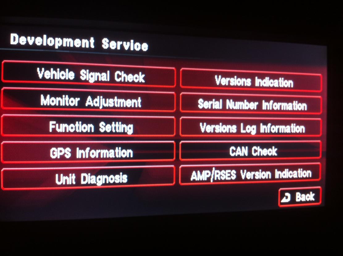

On a side note, I wasn't sure how many people were aware that there is another sub-menu located from within 'Service' (set + navi) screen. To access this screen, which is called 'Development Service', you press and hold the menu button down for about 3.5 seconds when you are on the 'Service' screen. Also, if you are in the 'Versions Indication' screen and you press and hold the menu button for about 3.5 seconds, you will be taken to a 'Loading Program' screen, as mentioned in my previous post. There may be even more sub-service menus that can only be accessed if you press and hold the menu button down when you are in different sections of 'service' but those were the only two that I came across.
Maybe everyone already knew about these extra hidden menus already since I know the MMCS has been out for awhile, but I figured I'd share it anyways to anyone who didn't know. Granted the screens don't mean much or do anything for me, but perhaps they can help aide in future developments for MMCS hacks and more.
I've attached a couple of photos of the screens.
