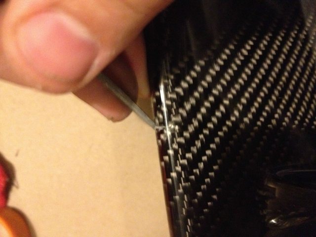

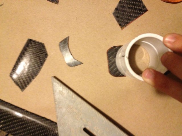

Does anyone have any idea what kind of tool i should use to shave this a little so it fits around the antenna? Any advice would be great appreciated. Should i just use a file? Sand paper? how did everyone else shave this so it fits?
it should fit theoretically...
here's one I did for a customer that I actually had to ADD to it

Hand sand or microfile, or both. I wouldn't use a dremel, rotary tools remove a lot of material really fast. On carbon, best to tape it, then use sandpaper with blocks unless you have a DA or variable speed grinder.
One the scale of carbon I make/fix that's nothing, if you want to mark where it needs cut and send it in I'll do it for you. i won't charge you anything but you gotta pay for shipping
