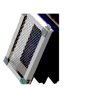

one of my friends and I actually are running a verion of this, but a little different. what we did was take the top of the stock airbox to make a custom version of the blitz air box. Baiscally, the top has a large square cut out and has mesh covering the open area to keep stuff out of the filter. Basically cheaper than buying the actual blitz induction cover for $200. I haven't gone on the dyno since I've done this so I can't back it up with hard numbers yet, But I can tell you that I haven't seen any negative effects since trying this. I am running the blitz high flow panel filter right now. I will let you guys know what it looks like after I get a new tune and see what the numbers look like. Maybe I'll see if I can do some runs with the normal airbox top and one with mine and see if it is actually doing anything at all for HP. I'll keep you posted. I have pictures of my air box top somewhere on evom

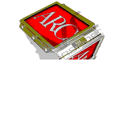

Just wondering if anyone has tested to actually see if this panel filter lets in hotter air than a cone style filter, which usually is closer to the engine than where the stock box is located (ARC air intake box/blitz air panel) I wonder if the "hot air" from the cone style vs. drop in makes a huge difference since there are major manufactures making these applications.
It Doesn't matter how hot the air is since when it reaches the turbo it gets heated up in the compressor.
