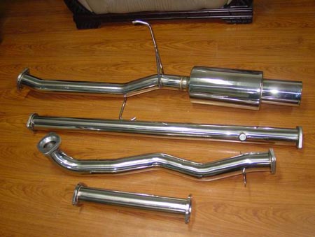

I'm thinking about buying this exhaust system for my OZ Rally Lancer, since it's non-turbo'd should i get something else? I'm not sure if non-turbos can use downpipes or not.
So heres the question(s):
-Would this fit on a Lancer OZ? It's suppose to fit the EVO8's.
-Would I have to toss the downpipe since mine is nonturbo and buy a med pipe or what?

if it's for an 8, then it would not fit, without some customization. 2.25" is about the largest diameter tubing you would want to use if you plan on staying n/a. Check the vendor classifieds section, RRM has been selling the Greddy Evo2 muffler for a serious discount, and then you can just have a local shop work up the tubing for you

what kind of customization would be required? Theres a shop that does really cheap work in town w/ welding and cutting.

they'd probly only end up using the muffler from that. the tubing will be to large and bent in the wrong places.
