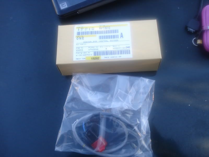

Hey i have Brand New oem Sensor for a 05/06 Evo. This is the front sensor and which is not cheap
ill sell it for 200 shipped
New it list for over 300 at mitsu
