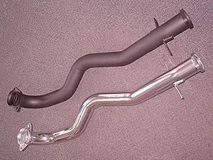

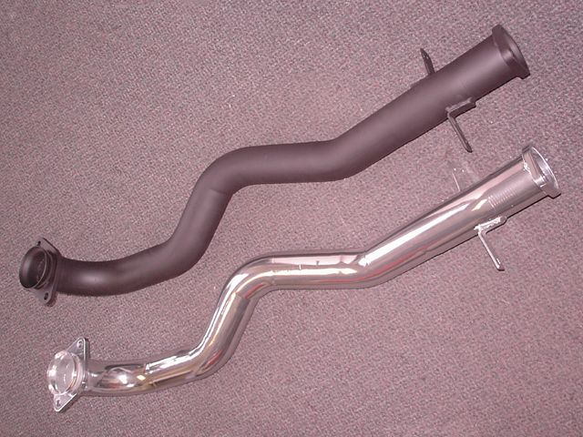

Old Nov 9, 2004 | 12:14 AM
simevo's Avatar
Posts: 591
From: SF, CA
Maybe stick with the Works 70mm DP. As you can see from the pic, Works DP has more bend around the TC area than most other DP which has minimal bends. Only way to fit a DP is to go around the TC on the '05 Evo and MR.
