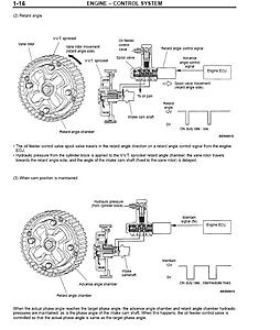

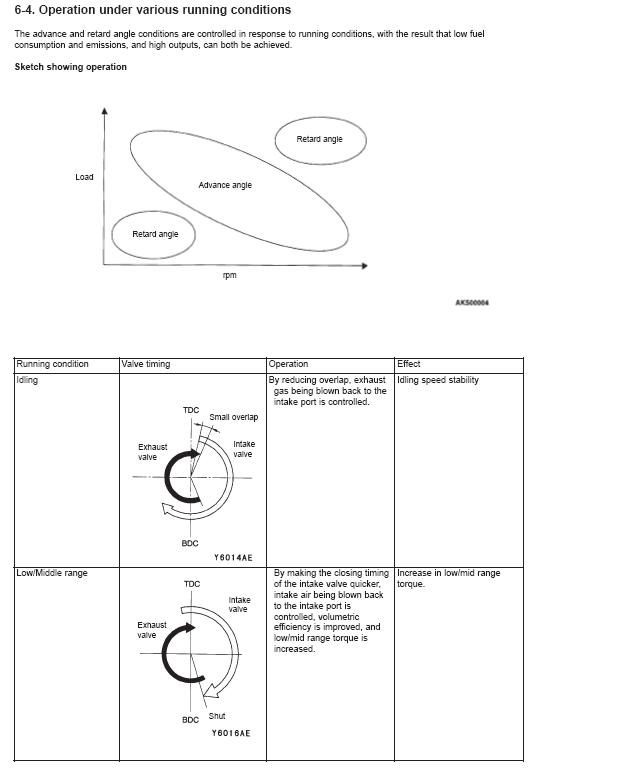

here ya go
Attached Thumbnails MIVEC and cams?-mvec1.jpg   MIVEC and cams?-mvec2.jpg   MIVEC and cams?-mvec3.jpg   MIVEC and cams?-mvec4.jpg   MIVEC and cams?-mvec5.jpg
