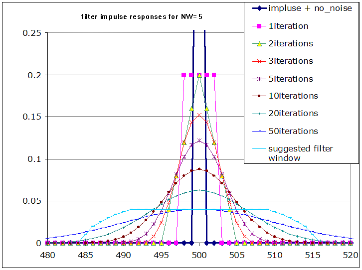

The reason you can find a "shift" which puts the interpolation back on the curve is because you know where the original location is. If you _know_ the underlying function, you can do a least squares fit or something and get a much better approximation. I have been unable to properly formulate the power/torque curve of a modern automobile -- at least in any kind of closed form.
I was only commenting on the observed shifts in your data because you gave the fit and the noise-less data. As for my fit, I did absolutely NO shifting to fit the original noise-less data.
Also, look at your first NNA plot. At an X_value of 50 your estimate looks like Y_estimate~15. But all the data from X>16 is all above 15. Clearly you are doing something wrong.
Actually the NNA plots _are_ using a 4 point window. The examples I've posted have the filters applied multiple times in order to exaggerate the effects. Each time you apply the smoothing, the plots shifts a little, but it's not a shift 4, 2, or anything that I've found to be meaningful.
Let me guess. In your simple test plots near the top, your "multiple times" was about 100, right? Since your averaging window 4 is even, you will get a 1/2 index shift each time you apply it. Your shift is about 50 so I figure you iterated about 100 times. Try your NNA's with an odd number so that you are averaging the target position and an equal # on either side and your pronounced shifts should go away (you can still obviously get some random shifts, but they should be much much smaller that the rediculous ones you have now).
Note: if you are using much more than 100, then you might be doing things better than I state above, but it is still clear you have an algorithm induced error.
Here's a plot of raw dyno samples, which I've found to be quite a bit more difficult to fit correctly.
Boy, that is some kind-o-crappy data. It brings to mind that there is no magic perfect filter for this kind of application where the actual values can have a relatively arbitrary form. You are basically stuck with a trade off between trying to reduce the noise and to preserve what you can out of the higher spatial frequencies.
That was dustin's car which should have a very stock evo-like poweband. What I don't like about NNA is how resistant it is to sudden peaks or dips.
Perhaps there is a better windowsize to pick for this particular example. Still, a moving window average will have the tendancy to push your points "up" in the direction that you iterate. Here, you can see that the hp level appears artificially high. It even appears to keep going after power is pulled (a little before 7k rpm if memory serves).
I am not sure what you mean by 'have the tendancy to push your points "up" in the direction that you iterate' but it seems obvious to me that you have an artificial ~450rpm shift in torque because of the way you are filtering. Since HP is proportional to TQ*rpm that MIGHT account for the HP shift, I can't tell. Again I urge you to use an odd # of samples in you NNA so that the averaging window stays centered on the target.
Also, your use of very small NNA windows and then re-using it many many many times seems counter productive to me. The width of the impulse response to such filtering is 1+(NW-1)*N_iteration (where NW is the width of your averaging window per smoothing). That is why the fit "appears to keep going after power is pulled" and you won't have very good ability to preserve any high to moderately high spatial frequency content. You would be better off using something like a single iteration of something like the "suggested filter window" shown in that attached plot (although you need to pick its 2 widths yourself). Yeah, the resulting plot won't look as smooth as yours do, but on the one hand you complain about lack of high spatial frequency responce
if on the other hand you want plots as smooth as yours in the presence of the kind of noise you have... well good luck. Sorry, but you can't have it both ways.
Alternatively, you can take a hint from the image process world and use a median filter or combine a median with one of a variety smoothing filters. The median will get rid of the bad "high flyers" that are obviously bogus and then the smoothing filters don't have to work so hard and can preserve more of the higher spatial frequencies.
Good luck,
B
That's not clear to me. If if my reasoning is incorrect I definitely want to know why.
An good guess, but incorrect. I'm only applying the filter 4 times (which a window size of 4).
Quite likely, although I _am_ using an equal number of points left and right.
EDIT: yup, you're right. One big glaring bug had me not using equal length windows on both side and that shifted everything WAY right.
[quote]
[quote]
Exactly. It's also the data of data where you want to be able to see very quick and severe dips as they can correspond to engine events.
Me too, but again, I'm not applying it a high number of times.
[quote]
[quote]
You're absolutely right. Using a low pass filter, it's not realistic to expect very smooth plots from such messy data.
Good luck,
B
Thanks!
d
