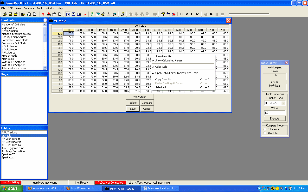

Just a few questions about the TunerPro RT software. In one of the other threads called "Screenshots", there is a snapshot of TurboBob showing the 3D pic of the VE table. I was looking at my VE table but its a tad different. I tried different settings here and there but no luck in getting it like Bobs example. One thing I did notice was that my version is 4.01 and Bob's is 4.12. Is this one of the differences between these two versions?

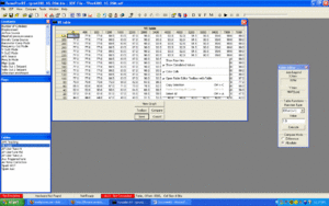

Also on the VE table, is there any way on version 4.01 to switch from "kpa" on the Y axis to "psi"? I read on another thread that you can do this if you right click on the table, but I wasn't getting anywhere with trying it that way. Here is a snapshot.

Use attachments to load a file.
My best guess is that the version Bob was using is for a different vechicle, there might be sligtly different variations to each select car.
I'll get backto you on the PSI to Kpa question, can't remember off the top of my head.

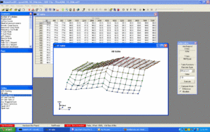

Here is a snapshot of my VE table'

There is a more recent version of tunerpro with improved graphing functions. (4.12)
Its in final test and hasn't been officially released. If anyone wants to try it, I can send it to you.
The axis nomenclatures are just labels. They can be changed to PSI in the XDF file.
I can make a XDF file configured this way if you want.
Bob

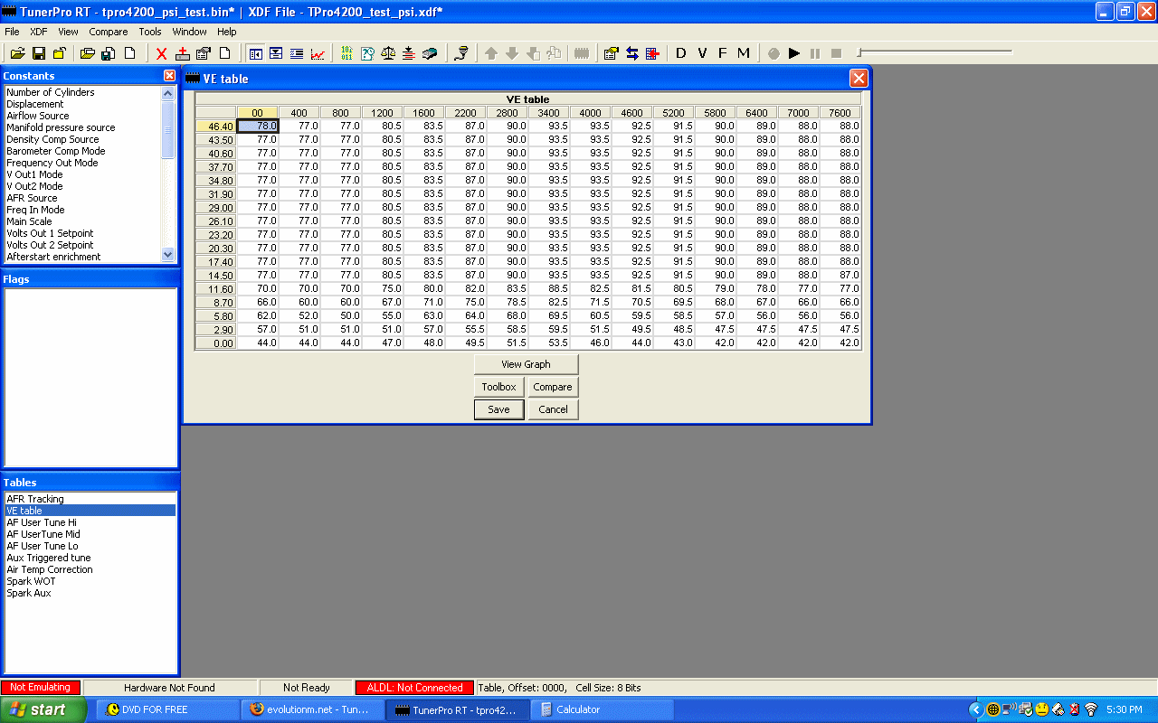

Nice, I wouldn't mind beta testing it. I did notice that you can edit the tables in the .xdf file, but I wasn't sure if this was going to mess with any hardcoded variables/functions already programmed in the MAFT Pro unit. I went ahead and created an xdf file with the variables set to psi. I just converted the equivalent to psi from kpa, since I wasn't sure if it would effect the way the software or unit would function. Here is what I got.
Looks fine. The labels don't affect the raw data, just how its displayed. In the case of the axis labels, the only effect is that the MAP tracing won't work since the axis labels are used to determine which cells to highlight to show the cells in use. If you want to use PSI, use - psi for the vaccuum region, so we can link the MAP tracing to the Boost pressure logging variable.
Your conversion is off. 14.5psi is listed x2.
